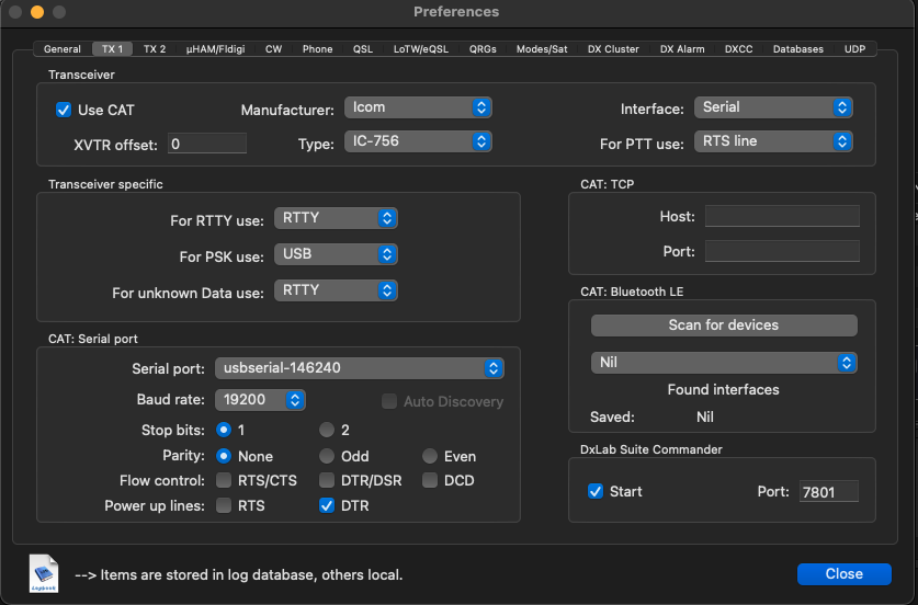

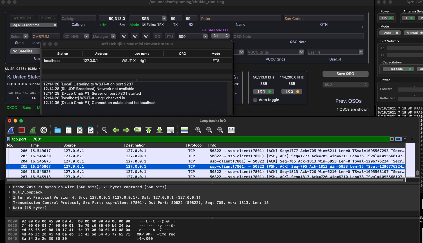

Here is a capture of the radio settings and the network dialog along with the wireshark capture. I turned off the port for the second radio and I disabled the exchange cat data on the UDP tab for WSJT-X. So the only active port should be the one for the 756 radio. The command to retrieve the mode works as I can change the radio mode and I see that response change. So that suggests that it is following the radio and the messages all lok well formed other than the frequency value. The network shows the proper port and the WSJT connection which is what I am using to connect.

I am using the formal WSJT-X 2.4.0 release. This is the actual exchange recorded from watching the network traffic. This works fine for my KX3 and a Kenwood radio with the same messages when I configure them to use a radio specific port. It seems to be tied to the 756. The set commands also work as WSJT-X can command the radio to change frequency. The commands to transmit also work. It appears isolated to the get frequency. And it is only a problem when using the DX Commander port on the radio tab.
WSJT-X sends:
<command:10>CmdGetFreq<parameters:0>
Rumlog responds with:
<CmdFreq:4>.000
This tells me Rumlog understands the request, but it is just not returning the correct value when it comes over the port set in the radio tab. So it feels like whatever logic that processes the incoming request to poll the radio state has some difference on the two paths for the Icom 756 Radio. The WSJT-X port returns the value from the active radio when there are two. And that always works. I can switch active radios back and forth and WSJT-X follows. I can point WSJT-X to the 2nd radio on the port defined in the radio tab and for the KX3 and the Kenwood that works. Making the 756 the 2nd radio does not change either. No matter which radio the 756 is, it does not work on the radio port. It is just the 756 that gives the bad response when using it's radio port. I don't have any other Icoms to try to see if it specifically the Icom 756.
