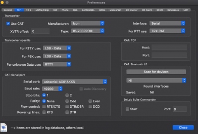

Ryan,
At about 57 seconds into the video, you can see my TX1 settings. Stop the video to study it, and then a few seconds later, and for only a second, you can see my settings on the RumLogNG uHam/Fldigi tab. I don't show the Contest Preferences Tab for RTTY, but it designates the RTTY interface as Fldigi. Let me know if you want my Fldigi configuration settings, but I believe they are just the basic ones. On the Fldigi Rig Control > flrig is set to 127.0.0.1 , the port is a mismatch on my Mac in Fldigi (12345) compared to RumLogNG (7362) and I can't explain that. But it works.
On the Mac, to get the function keys to work, System Preferences > Keyboard > Use F1, F2, etc as standard function keys.
On RumLogNG, to get the decode window to appear below the Contest Window, the contest mode is set to RTTY (or PSK31) and then the decode window will appear. The decode window only appears in contest mode. The transceiver needs to be set correctly as well, and on my 7300 because I am using AFSK, my rig is in USB-D mode; I think that is right. I don't have an opportunity to check at the moment.
A caution: the "Running" setting button which toggles to the "S & P" affect the behavior of "Enter Sends Message", so its best to experiment with it a little bit. Where the cursor is in the entry fields (eg "callsign" or "Number rcvd") will change the behavior of the enter key.
Hoop

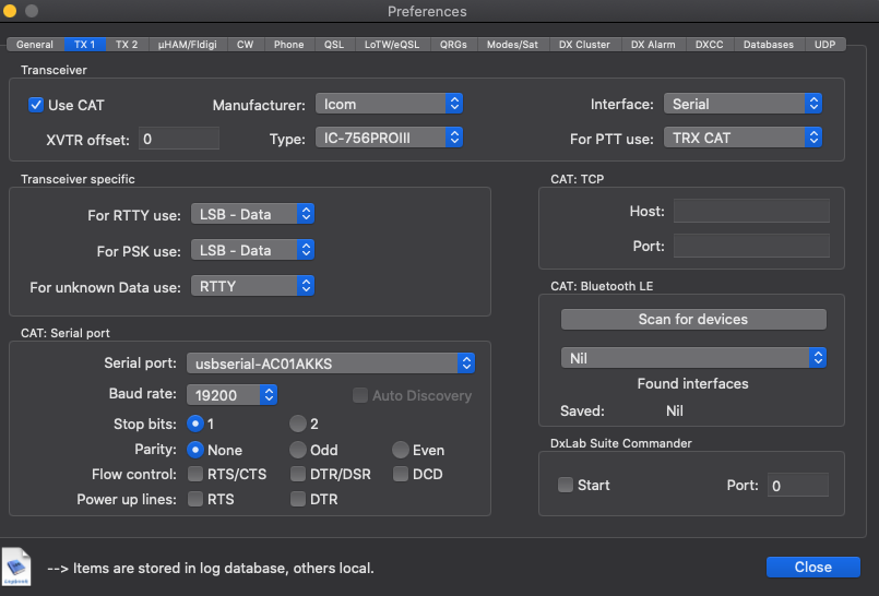

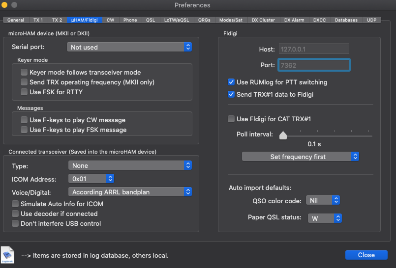

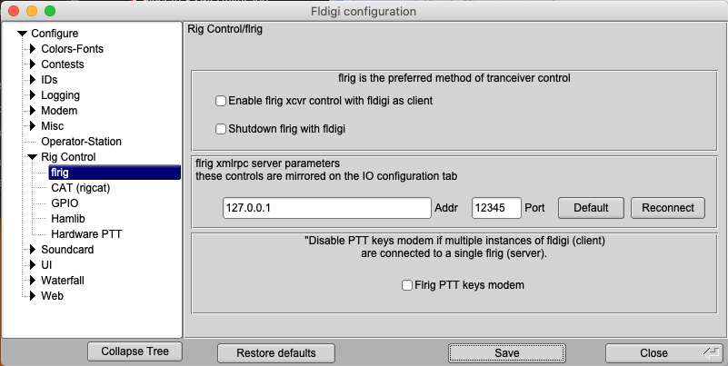

Hoop,
Thanks for the reply. I rewatched your video and mirrored your RumlogNG config settings. I also found the RTTY tab in the contest preferences window. I can now see the RTTY screen in Rumlog.
Flfigi has the default settings for xml server parameters, 127.0.0.1 port 12345. The settings in RumlogNG are 127.0.0.1 port 7362
I am not getting decodes from Fldigi into the RTTY window on RumlogNG, nor is the frequency info changing on the Flgidi screen. I suspect the xml server isn't working, I'm not sure how to fix this. When I press the reconnect button in the Fldigi configuration screen, Fldigi crashes.
Can anyone see what I am doing wrong?
Thanks,
Ryan

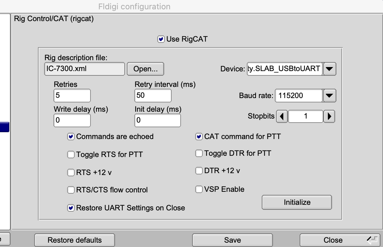

Ryan
I looked at your settings and I am not seeing any obvious differences. I note that, on the uHam/Fldigi tab, under Fldigi, the Host and Port fields are grayed out. Not sure why that is. The numbers are the same as on my configuration.
I do have RigCat enabled on Fldigi. That's a possible difference between our settings.
Hoop

Enabling RigCat shows the radio's frequency on Fldigi, but doesn't doesn't send any decode info from Fldigi to RumLogNG. Also, I've lost CAT control for Rumlog. I'm not sure how to get cat info from Fldigi to RumLogNG.
Your settings in the video seem very straight forward. I have duplicated them, but something must not be right in my Fldigi.
