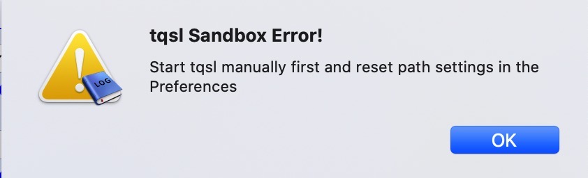

Greetings,
I'm at my wits end and desperately need help to overcome the dreaded tqsl sandbox error.
I'm using RUMlogNG 4.5 (385) on a mid-2018 MacBook Pro running OS X 10.15.1 Catalina. I have tqsl v2.5.1 installed and it functions perfectly when run alone.
Background: I've had tqsl working successfully with RUMlogNG for a couple of years until a few months ago. In the past, it seems like every time I updated tqsl I'd encounter the sandbox error again. I always managed to fix it by resetting the path settings in RUMlongNG. Then about two tqsl updates ago, I was never able to get rid of the sandbox error.
I've made sure all the basics are covered such as:
1. Verified tqsl functions properly when run outside of RUMlongNG.
2. Reset the path settings in RUMlogNG dozens of times, both with and without tqsl running.
3. I changed the path settings in RUMlogNG to something else, exited, then came back and changed them to the correct path for tqsl.
4. The tqsl app currently resides in the path: "/HD/Applications/tqsl.app"
5. I've also tried putting the tqsl app in the path: "/HD/Users/username/Applications/tqsl.app" but that didn't help.
6. I've deleted and reinstalled tqsl.
Any suggestions on what I can try next?

Pse post a screen shot of your LoTW setting tab and from the full error message.
Re: Help with Dreaded tqsl Sandbox Error!
Posted: Tue 17. Dec 2019, 00:09
by AA7US
Hi Tom,
As requested, the LoTW settings screen and the full error message are attached.
Please note that LoTW downloads (menu item "QSL -> LoTW in") works fine.
Thank you,
John
AA7US

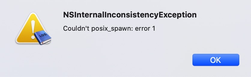

Posted: Tue 17. Dec 2019, 18:24
by AA7US
OK Tom,
I deleted RUMlogNG and installed RUMlogNG_Test.
After clearing the usual sandbox error popup, there was a second popup beneath which showed this:
I look forward to your suggestions.
73,
John
AA7US
Posted: Wed 18. Dec 2019, 04:37
by DL2RUM
Sorry, still no idea. What happens when you log in as admin?
