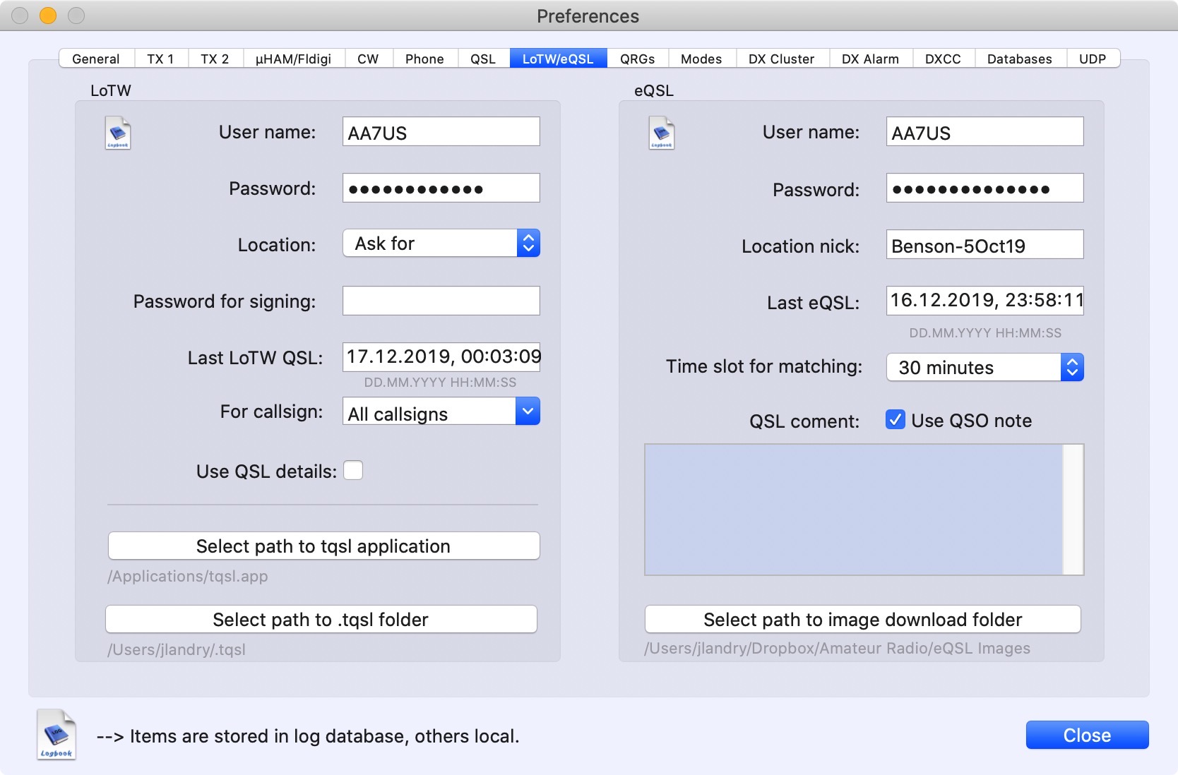

Pse post a screen shot of your LoTW setting tab and from the full error message.

Hi Tom,
As requested, the LoTW settings screen and the full error message are attached.

In the past, it seems like every time I updated tqsl I'd encounter the sandbox error again.
This is as expected and by design.
Your settings are looking good and I have no idea yet. Please try this version: https://dl2rum.de/RUMlogNG/RUMlogNG_Test.zip
