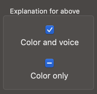

I have one question:
I have tried to disable the voice alarm from the Preferences / DX Alarm menu, but it stays active all the time and does not react to mouse clicks.
What am I doing wrong?
Can't this be disabled?
Thank you
Posts: 3139
Re: DX-Alarm
Make sure you have set all alarms according the help:
Screenshot 2019-04-02 at 14.59.53.png (23 KiB) Viewed 10312 times
