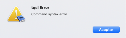

For a problem I had to format the HD. I installed the program again, everything works fine. I have the following problem, with the rise of QSOs to LOWT, the message appears: "tqsl Error, Command systax error".

You should try to upload a single record. Do you get always this error?

It does it with any registry, send them separately.

Recheck the station name.

I have done what you have indicated, I still can not upload the QSO, but I can download the confirmed ones.

Let the fields Station location and Signing Password empty.

Had the same problem;
Solved with this procedure; TNX

Thanks for the walk through. Helped me with LOTW in new install -- new to me MacMini.
