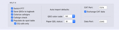

Dear all,
I just got this working with the settings as attached in screen shot. Hope someone will benefit from this.
I also got WSJTX to get the CAT data through TCI. But still finding routing audio to be a stumbling block.
Will update if I find any working solution.
Manoj VU2CPL
UDP settings for WSJT on RUMlogNG
Working settings for RumlogNG with TCI/ExpertSDR
