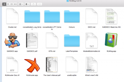

Show me the contents of the folder where RUMlog is located.
SV2AEG
Posts: 5
Joined: Wed 15. Dec 2010, 23:31
Re: dxcc.rsd
Unread post by SV2AEG »
Re: dxcc.rsd
Looks good. No idea. You should update to NG: https://itunes.apple.com/app/rumlogng/id964454561?mt=12
