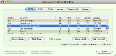

If you want to keep your own database, start EditDXCC.app from you RUMlog folder and perform the following:
Under the "DXCC" tab you can delete the entries for PJ2 and PJ7:

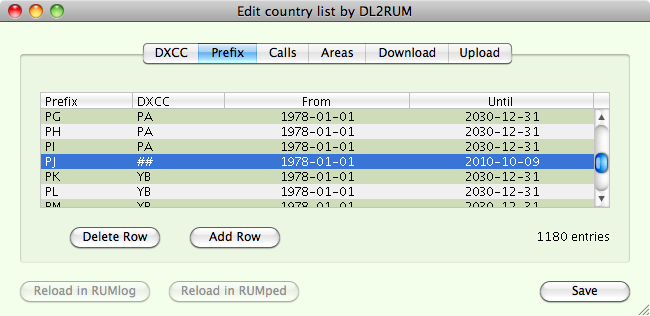

Under the "Prefix" tab delete all PJ1-PJ9 entries and add a new Prefix just called "PJ" and enter the following data:
The '"##" will mark all callsigns starting with PJ as invalid before 10-Oct-2010.
If you have callsigns from PJ in the "Calls" or in the "Areas" List, delete these rows as well.
Restart RUMlog
Your QSOs must me recalculated now. Use Menu-->File-->Recalculate DXCC. This will flag all QSOs with PJ as "Invalid for DXCC".

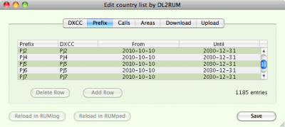

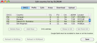

Adding the new entities
Under the DXCC tab add following rows: Under the Prefix tab enter following rows: When you have logged the new DXCCs already, you have to recalculate your log:
- Restart RUMlog
- Use Menu-->File-->Recalculate DXCC.

Just found the following: (http://dx-world.net/2010/new-dxcc-count ... formation/)
That means, the ADIF numbers I found first, are not correct.Below are what will be the DXCC assigned country codes for the new entities once they are entered into the DXCC system:
517 – Curacao
518 – Sint Maarten
519 – Saba and St. Eustatius
520 – Bonaire
Note, the country codes for what will be the deleted entities will not change, they will just be flagged as deleted entities.
Online, the only place where these codes are posted is in the text version of the DXCC list. Once we officially add the new entities to the DXCC software this list will then be updated to show the official changes to the DXCC list.
