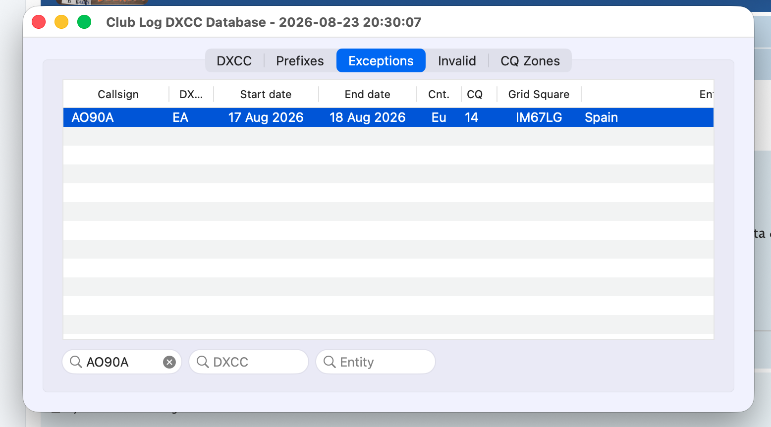

The CL updated DXCC list does show AO90A as an exception ( see photo)
yet recalculating DXCC for selected QSO does not change the logbook entry , it remains EA9N
