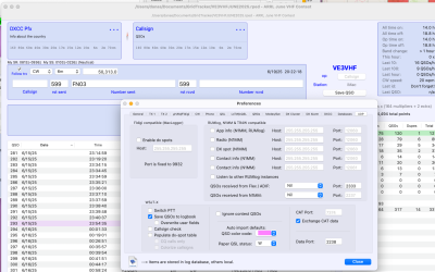

What do I set , so that WSJT QSO is automatically sent to the contest logging window (call and grid), to avoid manual entry mistakes.
Currently the QSO goes to my main log automatically., but not to the contest file.
Non contest automatic logging from WSJT and JTDX to Rumlog works fine....
Please explain procedure settings, what have I missed?
73 Dana VE3DS

Your screen shot shows the logbook preferences, not the contest preferences.
When the contest window has the focus, go to: Menu-->Contest-->Contest Preferences-->Network

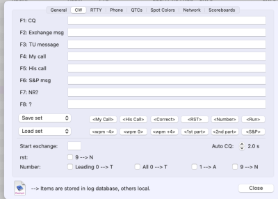

HOLY COW!
HIHI
I didn't even know this was there!!!
73 DS

All working now, even CW F keys...
73 DS
