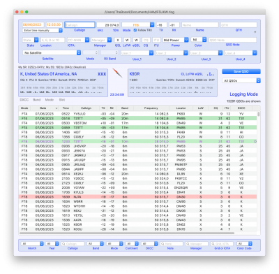

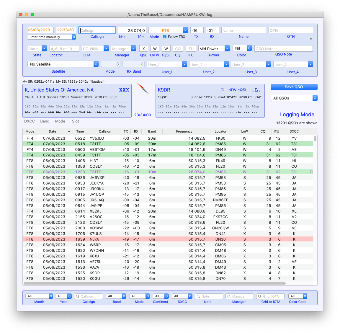

Hello
I'm used to import automatically my QSO from JTDX and all works perfectly.
However sometime I need to enter manually a QSO done and after saving it, the QSO shows up with a text color set to magenta (not the background color). How can I get ride of it?
Look at the attached screenshot, for T31TT on 10m (7th line from the top)
Posts: 3110
Re: Magenta color set when logging manual QSO
A callsign in magenta indicates an invalid operation. Stations from T31 need to be white listed. Is your DXCC database up to date?
See here: https://clublog.freshdesk.com/support/s ... whitelists
