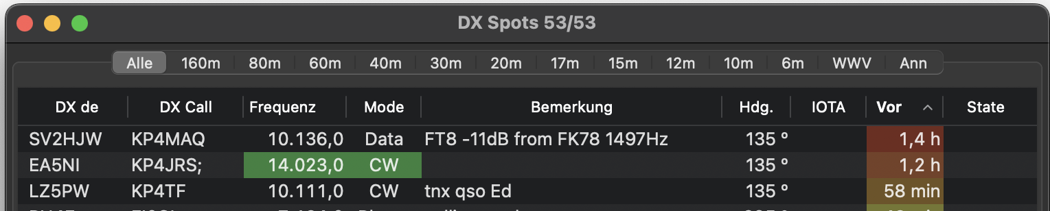

I am a new RUMlogNG user, and I want to know how the "heading" in the DX Spots window is determined.
I noticed that a spot for a KP4 (Puerto Rico) station shows the Heading as 270 degrees, which is incorrect since I am located in Chicago. I did set my grid square correctly in the Preferences General tab, so I assume RUMlogNG is not using my grid square to determine my location and then calculate the correct heading to KP4. Is there another setting that I have overlooked?

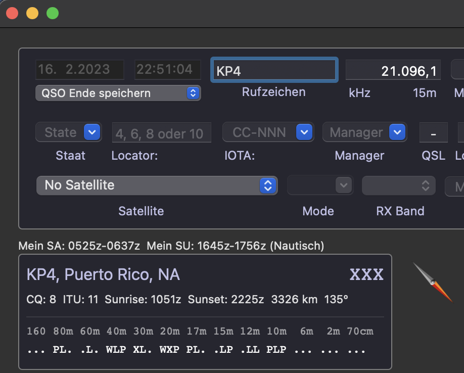

Where do you see the heading indicated? When I enter my grid square as EN61CW in the Preferences (which should be Chicago) RUMlog indicates 135º.

Hi Tom. I was looking at the "Hdg." column in the "DX Spots" window when I saw the incorrect value for Puerto Rico. Also, I was connected to an AR Cluster instead of a DX Spider cluster. The headings for all the other spots seemed to be appropriate. It was just that single value for Puerto Rico that puzzled me.
