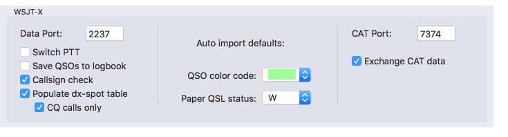

Problem: RumlogNG is picking up call signs from WSJT-X for contacts I work with FT-8, but it is not picking up decoded stations for spots or handing off decoded stations to SmartSDR for display in the waterfall.
Configuration of WSJT-X UDP Reporting attached

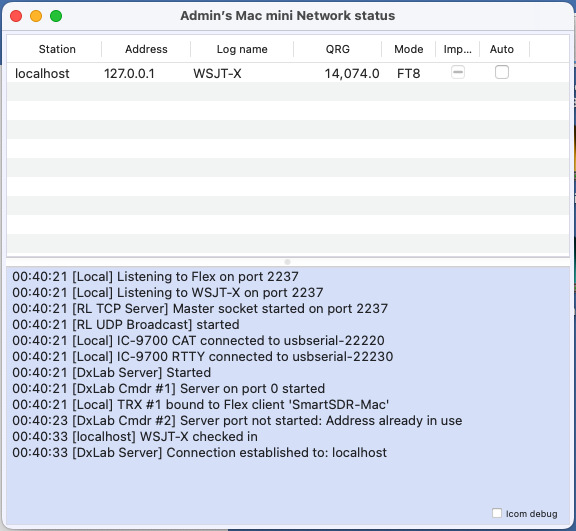

RumlogNG Network Status Screenshot attached
In the Network Status window the message "[DxLab Cmdr #2] Server port not started: Address already in use" is odd to me, is this the source of the error?

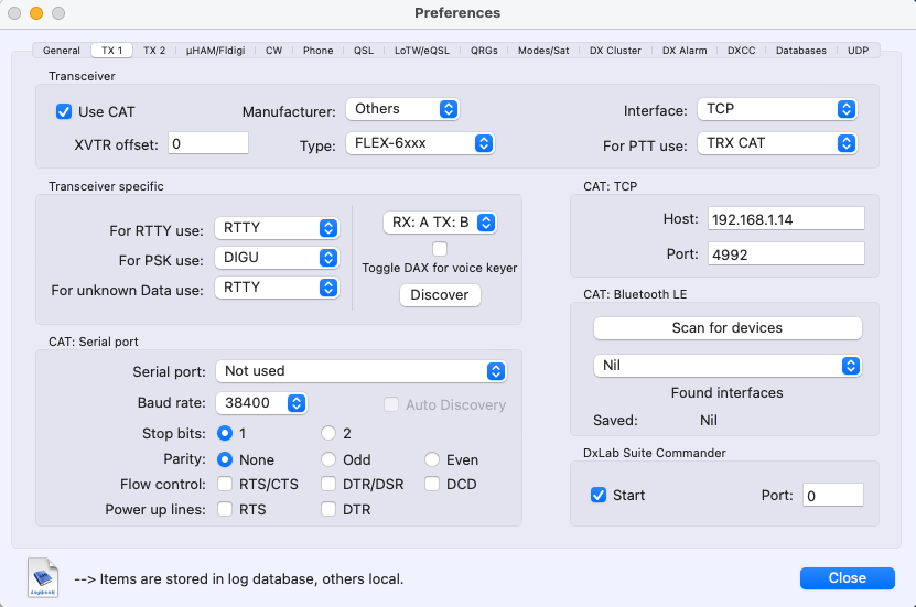

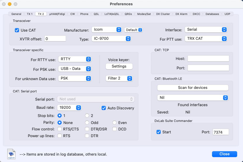

Thanks David for your new year wishes. Have changed UDP server from the multicast IP address to localhost as instructed. Radio is passing frequency information to RumLogNG, but callsign information for stations I am contacting in WSJT-X are no longer being passed to RumLogNG and I have to manually input the callsigns.
As before, decoded stations are not showing up as spots when appropriate and WSJT-X is not handing off decoded stations to SmartSDR for display in the waterfall. As requested TX1 and TX2 are attached.

According to your rig’s setup there are 2 mistakes:
at your TX1 the DxLab Suite Commander is enabled but port is 0 and it should be 7374.
at your TX2 the same Commander is enabled but no need to be it on, it will work much better without it enabled.
Do changes and let us know.

Just a note, do not enable DxLab Suite Commander in TX1 and TX2 and do the following setup at RUMlogNG setup:
Let me know if everything well now.

2. In RumLogNG on the "TX1" tab changed the DxLab Suite Commander port to 7374
3. In RumLogNG on the "TX2" tab turned off the DxLab Suite Commander

Your change 1. it is ok.
Change 2. it is not needed.
Change 3. it is ok.
Change 4. it is ok.
