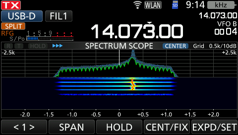

Now get "Big" signal wide and choppy on the waterfall

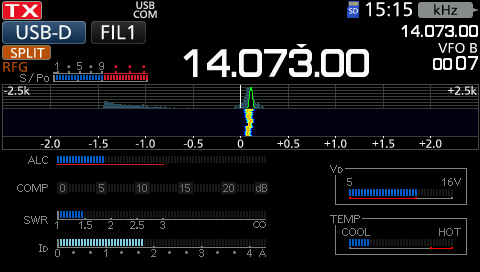

a more normal signal from direct usb connection :

I'm doing something wrong , I was over driving the audio. But when I lower the power/volume , the transmit signal on the scope looks bluish , not yellow or red and I don't get spotted
When I switch back to USB , the trace returns to normal yellow and I get spotted
I am using mod input WLAN and the WLAN mod level has been 50-70%
