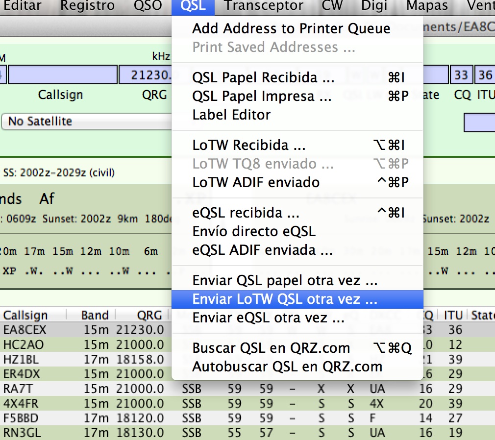

I use this via to upload LoTW QSL

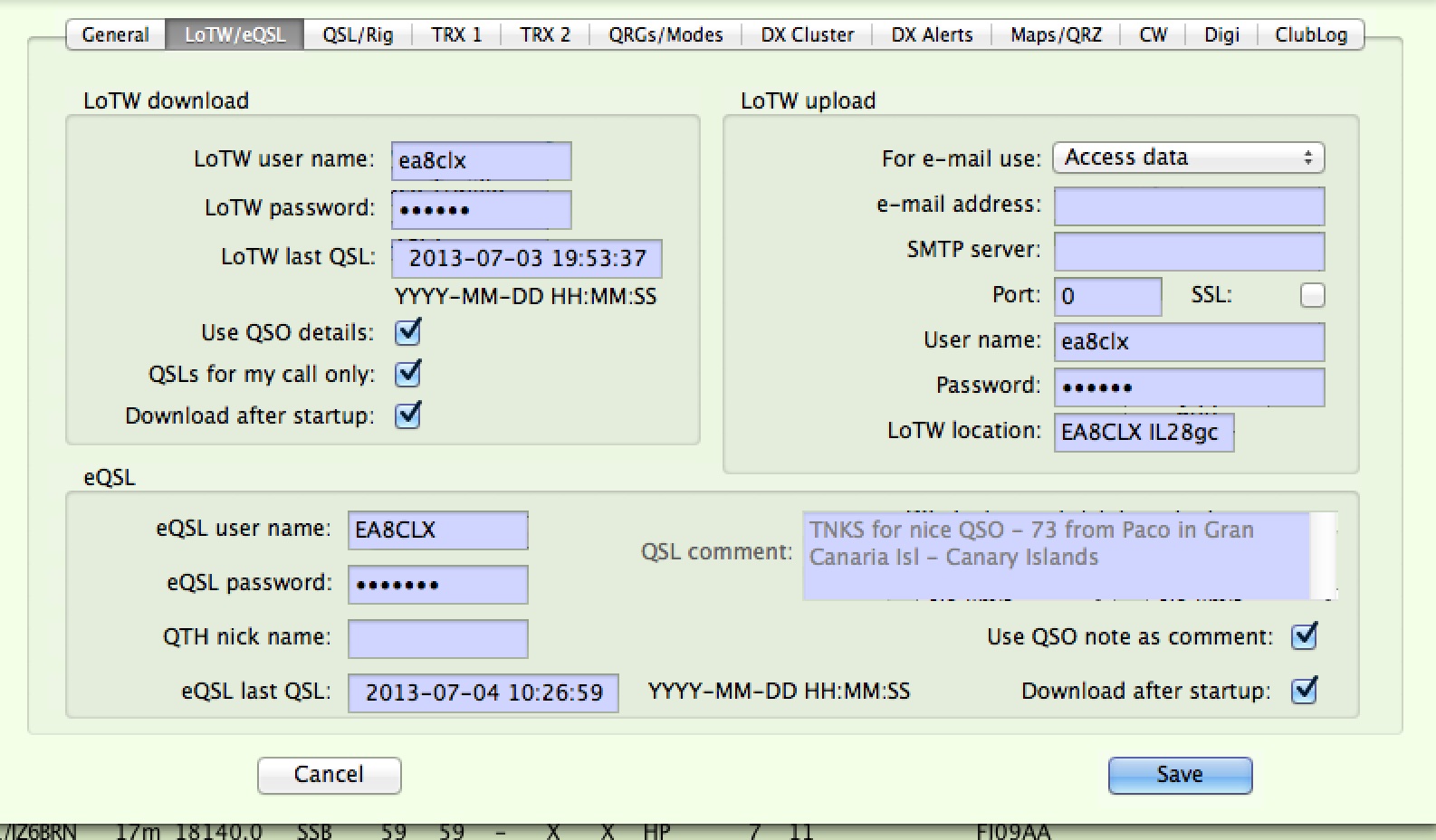

And this LoTW settings, the download with their pass, the upload i test with same pass and with my personal pass

I can't read the Spanish menu, but it seems you have selected the wrong entry. The command you have used is to change the LoTQ QSL status back to W to mark the selected QSOs for another upload.
Use Menu-->QSL-->LoTW ADIF out or Menu-->QSL-->LoTW -->TQ8 out.
Also, you haven't entered all necessary data in the preferences. It is more easier to use Mail for sending the mail. You have selected "Access data", so you have to enter all email access data for your email account.
Don't forget to put a copy of tqsl into the RUMlog folder.
See the manual pages 32 ff and 71 ff.

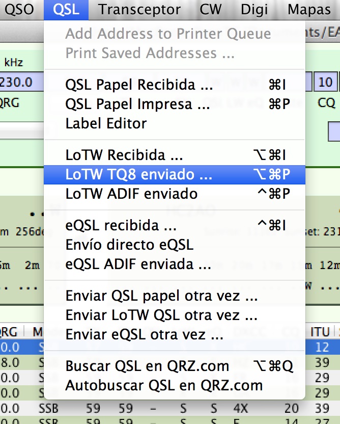

Any suggestion:
In the LoTW 3 options quote in Spanish: LoTW TQ8 "sended" and no "send" LoTW TQ8
LoTW ADIF "sended" and no "send" LoTW ADIF
In the 3 send options quote: Send LoTW QSL again (How send LoTW QSL again ??)
