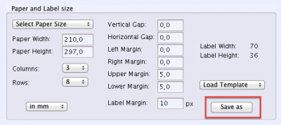

Well, it does use the same label template, but it appears that the page layout values are not saved. For example, if I go to the label editor, I see that the vertical gap is 0.00", and the QSL labels print fine, but the address labels have a larger gap, so the rows are shifted a bit, and the bottom address lines runs into the next label.
Re: Feature question/request: address labels
Please send me your label layout for investigation. In the label editor use the "Save" button in the "Paper and Label size" section.
BTW, make sure you have set all borders to 0 in the OS-X printer settings.

DL2RUM wrote:Please send me your label layout for investigation. In the label editor use the "Save" button in the "Paper and Label size" section.
