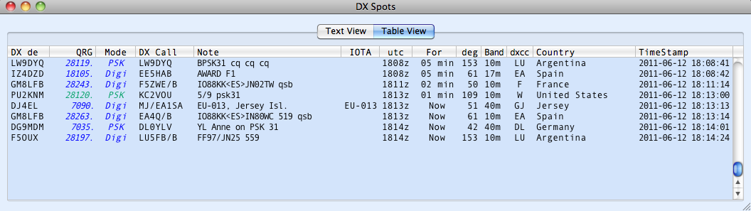

I have installed the 4.7 version of Rumlog onto my computer. I'm running OS X 10.6.7 on a 24" 2.66 GHZ Intel Core 2 Duo. When I use the new table view of the DX Spots window, I can't get the decimal portion of the frequency to show, regardless of how wide I make the QRG Column. A screenshot of what I see is attached.
Have I not set something up correctly?

It seems all systems are affected, where the decimal separator is set to a '.' (dot)
This will be fixed in the next update.
As workaround you can temporally set your decimal separator to a ',' (comma), start RUMlog and reset it to your default. You can find this setting in the OS-X System Preferences-->Language&Text-->Formats-->Numbers-->Customize
