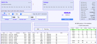

Just used RUMlogNG 3.3 for the CQ WPX 2017 contest. It seems that the number sent did not index after each QSO, it kept returning to "5". I had to manually type in the correct QSO count. I am using an IC-7300 on OSX Yosemite 10.10.5, iMac mid 2007 (old one!). Not sure if I have the same problem with other contests, I did not try yet. Please help!

Please post a screen shot of your logging window.

Counter reset to "5" again!

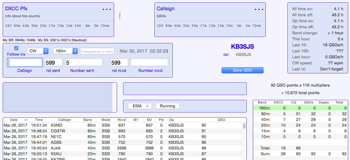

Re: CQ WPX number sent not indexing
I want to see the full window, including the title bar.

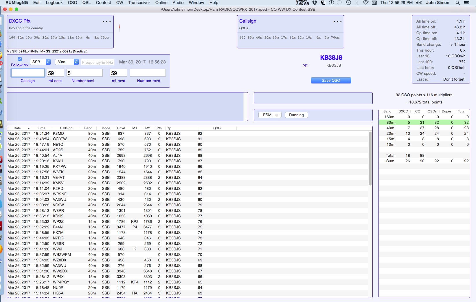

Here is a full screen shot.
Posts: 3110
You have selected the WWDX contest, not the WPX!

Thank you Tom, yes indeed, RUMlogNG copied "5" because that is my CQ zone, the exchange for that contest. And yes, I did the whole contest using the wrong plugin. Oh well, thank you for getting me straight!

The name of the used contest is clearly stated in the window title.
