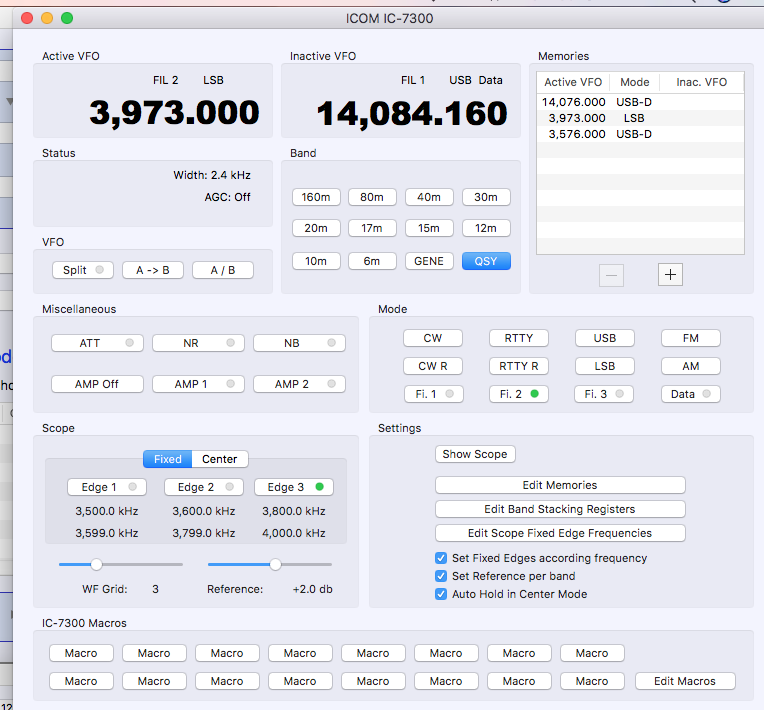

When I have the "Set fixed edges according to frequency" checked it automatically jumps to Edge 3. My radio freq. is set to 3.576, but it still jumps to Edge 3. If I click on Band Edge 1 it'll automatically jump to Band Edge 3, even when my radio frequency is 3.576. It stays on Band Edge 3.
I cannot get it to work when tuning up and down the band.The band edges do not change as I'm tuning.

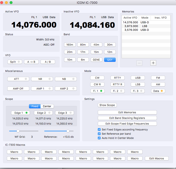

My band edges are:
14.025 to 14.070
14.071 to 14.150
14.225 to 14.350
On 20 Meters I can use the IC-7300 control to switch between band edges (unlike when I'm on 80 meters), however it still does not change band edges. I tune up and down the band and the screen does not change band edges.

Do the read outs below the Edge buttons show the correct selected values?
A screen shot of your settings would be helpful.
A highlighted button in macOS means always, that this is the currently default button. Just hit the Enter key to perform its action.

Yes, it looks like eveything is correct.
