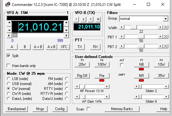

Thanks. I believe that folks would use it. DXLabs for windows has had this "feature" for a long time and people use it a lot. You can create either push buttons or sliders. Since the 7300 only has a few dials on the radio being able to create your own macros would be a real nice feature. You are correct that it takes a little "programming experience" to set up the macros. As you know all the manufactures publish the command sets. The 7300 is a great little radio but having most of the controls menu drive is a bit of a pain. Just remembering what menu you need to go to for me and according to the 7300 forums is a challenge for a lot of people. I would ask that you please consider this since I think more and more radios will become SDR based and the 7300 is leading the way.

Here is a link to the on line documentation. Dave, AA6YQ, does an excellent job of documenting what he does.
http://www.dxlabsuite.com/commander/Hel ... uences.htm
I uploaded a file showing what my system looks like. Look under user defined controls. You have pre-defined buttons to set specific settings like 10 watts and and sliders which let you vary the control from say 0 watts up to 100 watts.
