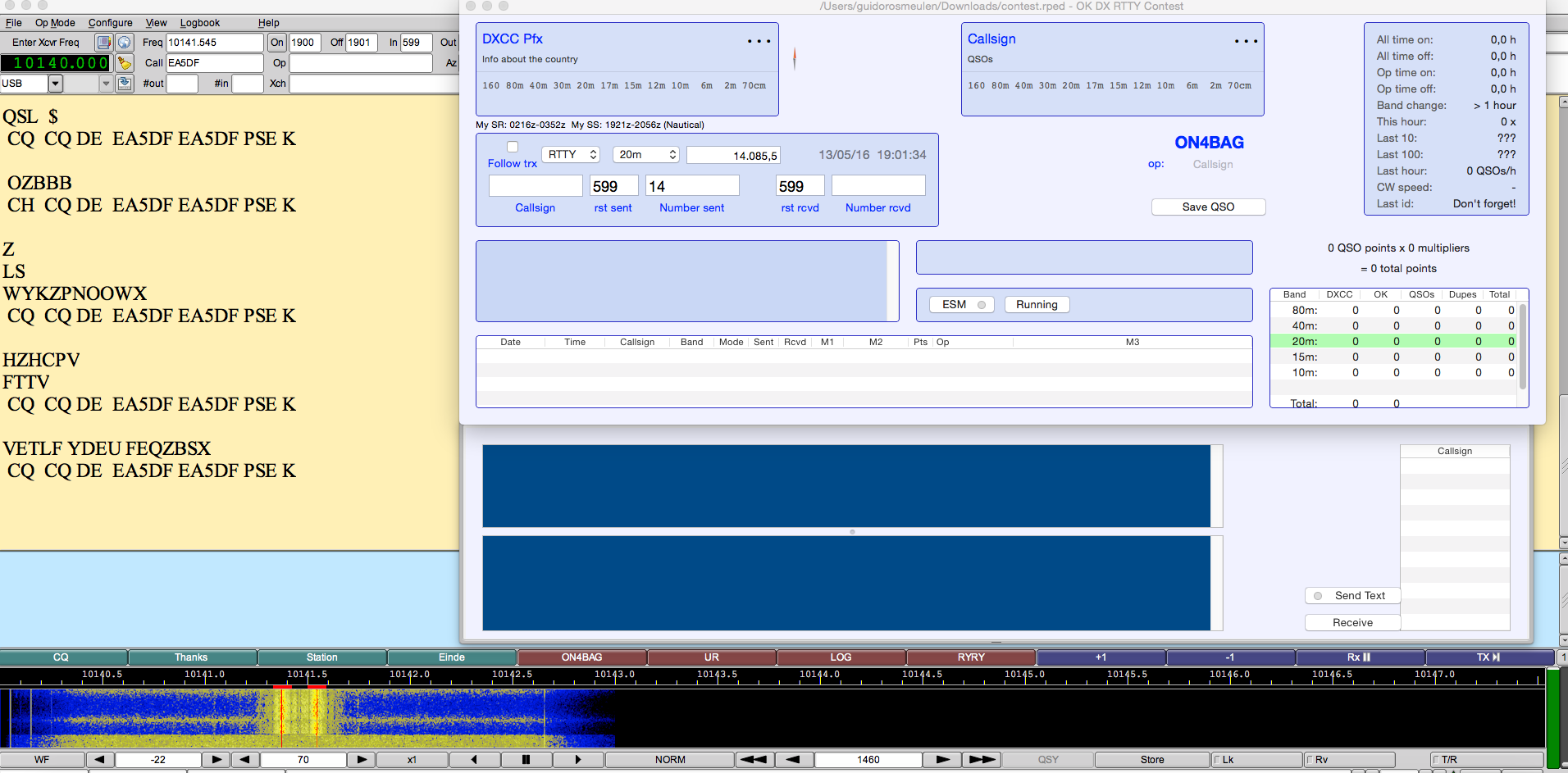

I use FLDIGI and Digikeyer 2 as interface (The small screen of microham see my DK2 => green button)
See screenshot : Is it the goal to have in one of the blue screens under the logging the same text as I have in my fldigi screen (someone calling CQ in this case)

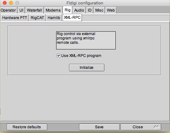

I have set XML-RPM in FLDIGI on
Am I doing something wrong or am I not understanding the purpose of these 2 blue screens ?

RUMlog and Fldige show different frequencies. Are you sure, you have a working xml-rpc connection between the programs?
You should show us your trx and contest RTTY settings.

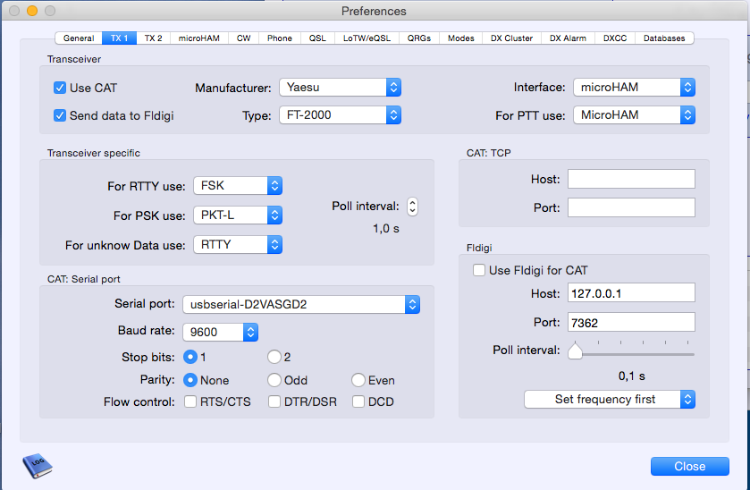

Attached de scrresnhots

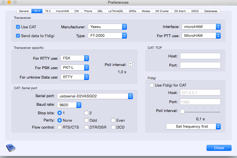

But do we need get the CAT correct in Flidig also (with Hamlib ?)
see screenshots
73 Guido ON4BAG
Posts: 3124
Re: RumLogng - Contest mode
You don't have set the address and the port for fldigi.
ON4BAG
Joined: Sun 13. Nov 2011, 18:39
Unread post by ON4BAG »
It is working fine now
I only have set in FLDIG the XML-RPC and in Rumlog the correct setting. Is also set the correct port for FLDIG (that was one I forgot)

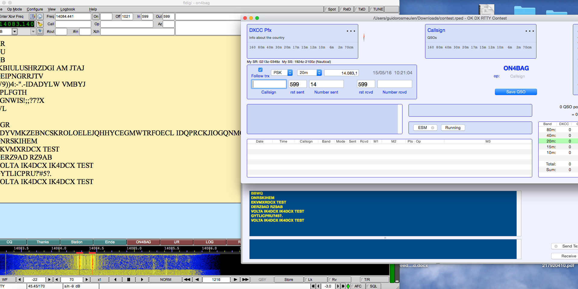

Data is coming over now to Rumlogng
Screenshot attached
