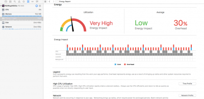

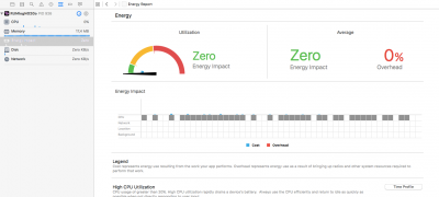

The tested Adafruit BLE device pulls just 3-5mA at 5V, while the Piglet (http://pignology.net/piglet/) needs 50-180mA! Clarke has found out while using it in the field, the iPad battery life is reduced to ca. 60% when using the WLAN connection for TRX control. See the graphics below.

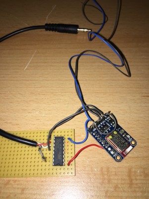

On the other hand, you have to build your own interface. The signal lines need to be inverted. For testing I used a simple 74HC4049, powered from the 3.3V voltage regulator on the Adafruit board. The KX3 works fine with this level. Other transceivers may need a MAX232.

iPad Energy impact for WLAN interface
iPad Energy impact for Bluetooth Low Energy interface
Used prototype to test with a KX3

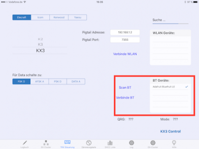

To use it on your iPad, go to the TRX Control section and push the "Scan BT" button. Found supported interfaces will be listed in the table. Select the interface you want use. Press the "Connect BT" button or go to the K3/KX3 control screen if you want to use it. Here you will find a "Connect BT" button as well.
