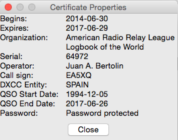

Re: TQSLLib Error
Can you show us a screen shot of a certificate?
ea5xq
Posts: 97
Joined: Fri 11. Apr 2014, 16:45
Re: TQSLLib Error
Unread post by ea5xq »
Here it is
73's Juan, EA5XQ
http://www.ea5xq.net
Posts: 3124
Re: TQSLLib Error
Looks good, You should check now the logs in the hidden ~/.tqsl folder. Files are named curl.log and dberr.log.
