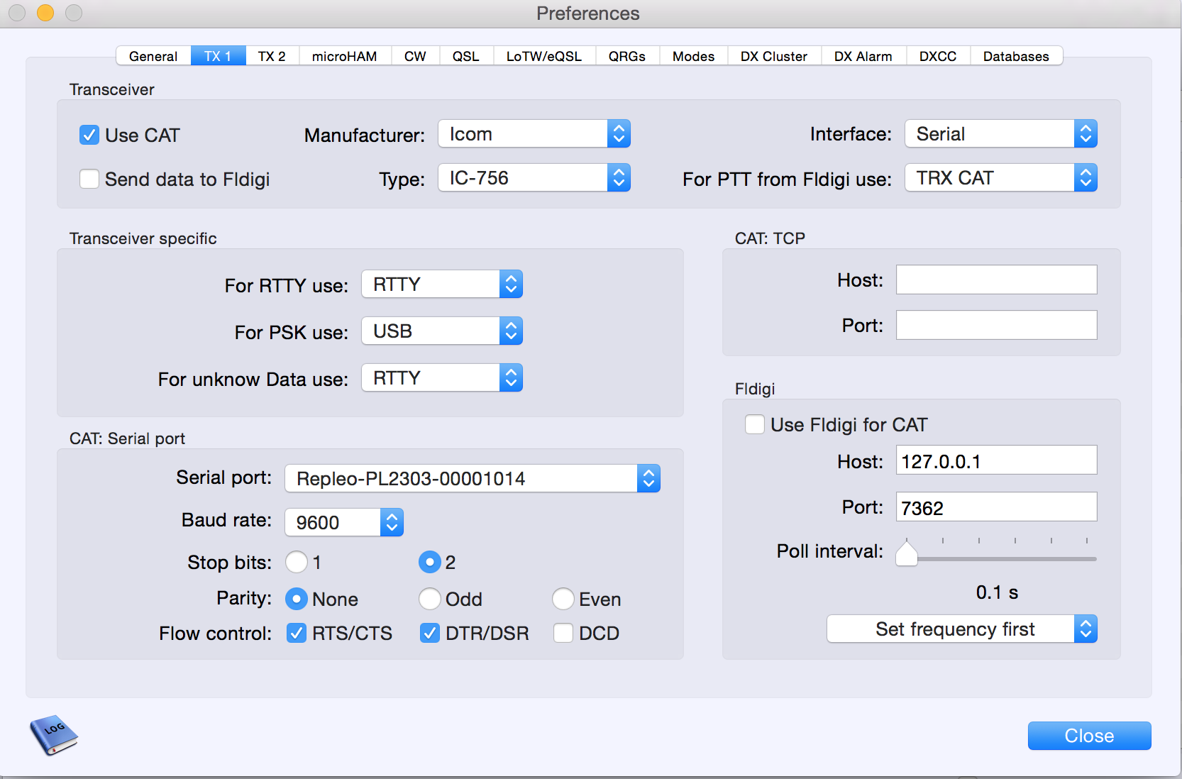

I am trying to manage IC756 from RMNG and facing some troubles. Attached the configuration.
Menu of IC756: CI-V baud rate = 9600, CI-V address = 50h (default), CI-V transceive ON
I have tried the same configuration with TRX1 and TRX2 and there is not way to change the frequency but...
If configure TRX1 = TRX2 and keep both activated, only change the frequency of IC756 (and not always) if I choose DX spot and then RESET CAT#2.. but not in all the times...
What am I doing wrong?

Why do you use 2 stop bits?
Are you sure you have to use rts and dtr?

Sorry, I did not pay attention to that. There were the configurations for FT857 and are different for IC756.
Stop bits are 1, parity none and DTR/DSR as flow control. Now works fine. Thanks!

It should work in the same way. Why do you have set DTR/DSR for flow control? The standard Icom CI-V interface doesn't support it.

Yes I know, I was just testing all the possible options just in case .. and the picture was related to the test.
In theory it should be 8 bits, no parity, 1 stop bit and no flow control but and speed should be the same (I tested with 4800, 9600 and 19200), all of them in TRX2 (I suppose that it will work the same as TRX1)
Works fine in one way but no in the other...
