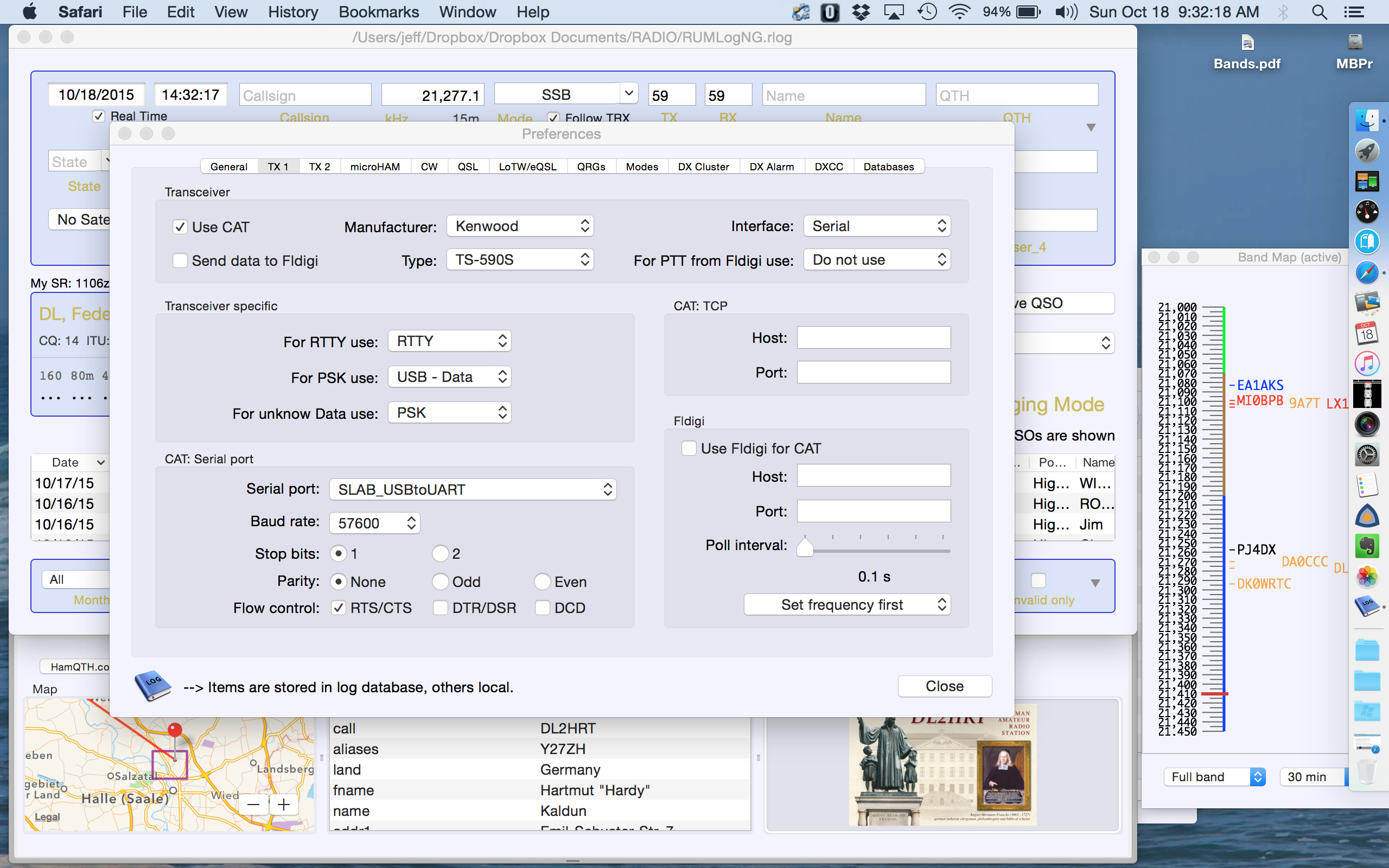

Thank you for your reply. I have deleted the various files in the Containers file for RUMLogNG, and allowed those files to be recreated. I have also found that there was a problem with data communications using fldigi, but those problems existed when using UHF/VHF transceivers concurrently with my HF transceiver. When I do not use that equipment concurrently with the HF transceiver, fldigi operates properly, and RUMLogNG works properly except for one residual problem: the frequency display in the main logging window does not change as I change frequency on the transceiver. There is 2 way communication between the band map and transceiver, and other aspects of the program work properly. I can control the radio using the band map, and clicking on the band map controls the radio. The band map follows the radio frequency. I have uploaded a screen shot of the settings.

When the pointer in the band map moves, I don't see a reason why the frequency read out is wrong.

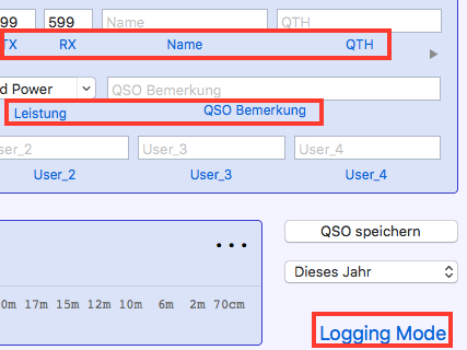

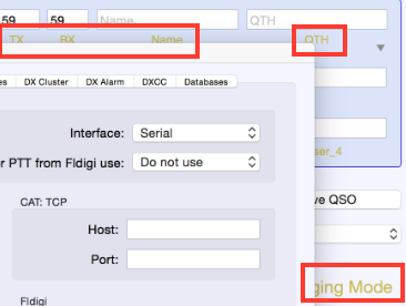

The text labels in your screen shot look brown. Why? I'm confused, just seen another shot with magenta colored text labels. Text should be written in light blue and "Frequency" and "Mode" in green, when trx control is active.
You don't have configured Fldigi in RUMlog. Do you use CAT from Fldigi as well? At the same time?

Please look at the attached screenshot. The color of the text seems to be brown, it should be blue. Maybe the window don't initialize correctly. Make sure you have connected all devices and powered up before you start RUMlog. Please check Console for messages regarding RUMlogNG.
It should look like this:

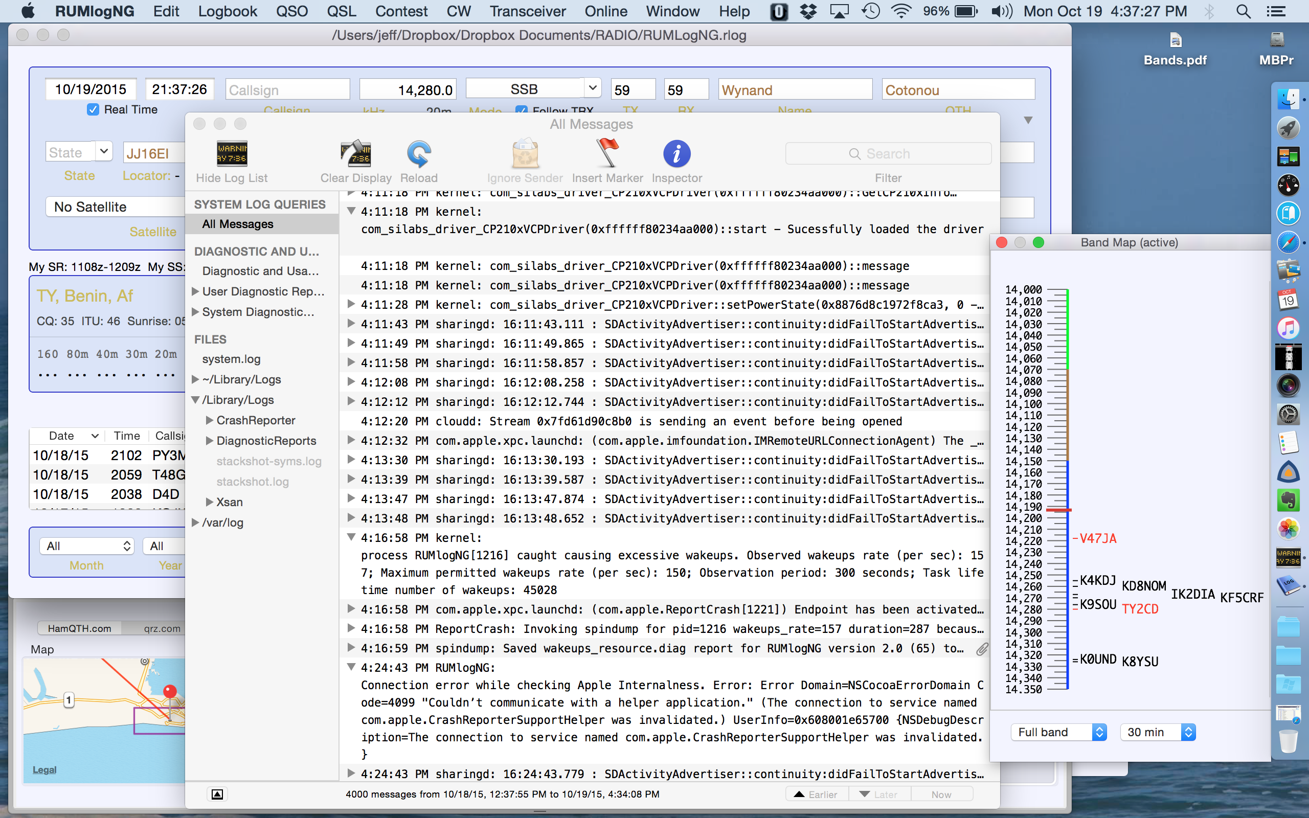

I am using RUMLogNG v 2.0 (65). I understand your comments about the change in colors--they had previously been as you describe. I have attached a screen shot of the console report--there are references to RUMLogNG.

Jeff, in Console please enter RUMlog into the search box in the right hand upper corner. Use copy and paste to post the text here. No graphic please.

If I disable CAT, close the preferences box, then enable CAT, close the preferences box, everything works properly, with full 2-way communication. However, the colors still do not change back to normal. I have to repeat this sequence every time I relaunch RUNLogNG.
The messages I see in console are the following:
10/20/15 5:04:14.690 PM sandboxd[285]: ([4975]) RUMlogNG(4975) deny mach-lookup com.apple.CrashReporterSupportHelper
10/20/15 5:04:14.645 PM RUMlogNG[4975]: Connection error while checking Apple Internalness. Error: Error Domain=NSCocoaErrorDomain Code=4099 "Couldn’t communicate with a helper application." (The connection to service named com.apple.CrashReporterSupportHelper was invalidated.) UserInfo=0x608000c7f180 {NSDebugDescription=The connection to service named com.apple.CrashReporterSupportHelper was invalidated.}
