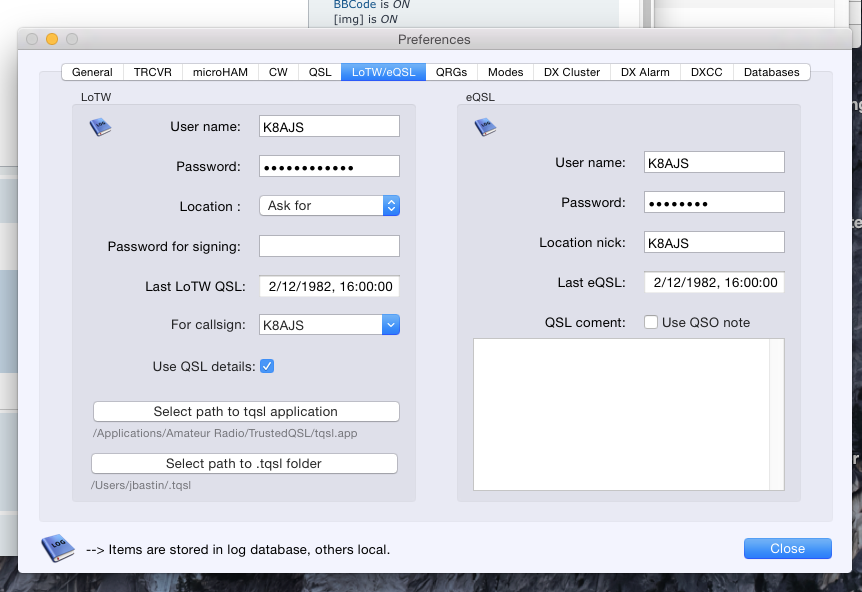

Is your call sign and your station location seen in the RUMlog Preferences under the LoTW tab?
Please post a screen shot of this settings.

My callsign is there. My location says "Ask for" and I answer that question from TQSL when I do the upload, because i have more than one active certificate in TQSL. When I tried to do the upload, TQSL ran and asked me for my selection, where I selected "K8AJS" in this case.

Your settings are looking good, hard to trouble shoot from here.
Is the popup (where you have selected 'Ask for') filled with all of your locations?
