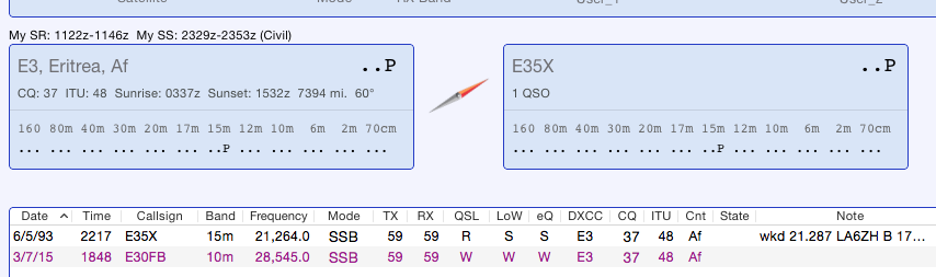

Today I logged a QSO with E30FB. In the log grid the text is magenta and the Q doesn't show in the DXCC info box. What does the magenta color mean?

A QSO line in magenta can mean:
  • QSO is invalid for the DXCC (this should be your case)
  • DXCC is a Deleted Entity
You should watch to the info boxes during logging:
  • Text in Station Info Box written in magenta: Invalid operation, declared by ARRL DXCC desk
  • Text in DXCC Info Box written in magenta: Deleted DXCC Entity
See here for further information: http://www.clublog.org/test.php?call=E3 ... &minute=52
You can check for E30FB entries in your local dxcc database using Menu-->Online-->Show DXCC database
Since the status for E30FB changed for few days you should update your database using: Menu-->Online-->Load DXCC data
After that (it takes few minutes - watch the status above the Station Info Box), you should select the affected QSO lines and use Menu-->Logbook-->Recalculate DXCCs
A feature is planed to do this task automatically after changes.

DL2RUM wrote:A QSO line in magenta can mean:
I don't see how this would be. The ARRRL says "15 (E3) Only contacts made November 14, 1962, and before, or May 24, 1991, and after, count for this entity."
It does not make sense to me ClubLog would regard this as an exception. For DXCC tracking, the ARRL is the only rule thatmatters.
I got the message that E30FB is valid, but the line in the grid remains magenta, and the DXCC info box is unchanged.

Found more useful information about white listings and the idea behind it here: http://clublog.freshdesk.com/support/so ... whitelists
Concerning your log, I have to check. As workaround try this:
  • Double click the E30FB QSO - This brings the QSO into the Edit Mode
  • Change the callsign
  • Change the callsign back
  • Press Save

ClubLog has the right to apply any rule they want to their database.
I disagree strongly with their reasoning and reject the idea it governs my database. E30FB is a perfectly valid and legal callsign according to ARRL, whose tracking and awards I am interested in. If NG is going to follow ClubLog rules, then I suggest adding the ability to add it to my local database. RUMLog classic accepted it without question, as it should have.
The workaround didn't work, sadly.

In fact, using the Clublog databases, we have more advantages than disadvantages. When you update the database frequently, there should be no issues. Clublog updates it daily.
In the Preferences under the DXCC tab, you can still define your own exceptions.
For E30FB you should delete the QSO and enter it new. I found some bugs concerning recalculating. I was not consequent, or changed my mind during development. Sometimes the statics counts invalid entries, sometimes not. I change it, so invalid operations will always be counted in the statistics, but are magenta in the log.

After updating the database, deleting the Q and re-adding it worked FB. Looking forward to the auto update... :P

Just worked EP3ASA. It was magenta, but changing the callsign and then back again as Tom mentioned worked. This was on 5.6.1.
