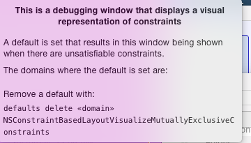

When I try to import adif to NG I get a purple screen exception as attached.

Yes, open the log program, with empty log, then hit import ADIF...
select file...
Then it seems the process hangs or slows down, then purple exception screens...will try to do a screen print
with the text ... almost looks like some kind of field parsing of the ADIF table...
73 Dana
This is purple screen
Screen Shot 2015-02-19 at 8.24.16 PM.png (31.15 KiB) Viewed 10011 times

Very interesting. I have an idea what happened, but I don't know why. It seems you are the only one with this problem. It seems to me, the window in question is a standard OS-X open file requester. You was not able to select a file before the crash happened, right?
Please try the following:
  • Start RUMlogNG
  • Open the Terminal and enter as mentioned in the printout:
     defaults delete de.dl2rum.RUMlogNG NSConstraintBasedLayoutVisualizeMutuallyExclusiveConstraints
  • Go to the ADIF import
This flag will be set each time RUMlogNG starts. When this workaround works for you, I will remove this flag from the code. It is a trouble shooting aid for windows wit an incorrect layout. In this case, I have no control, since it is an OS-X window.

Tom, ran script, now purple screen gone.
Tried to import ADIF to log, did not work
