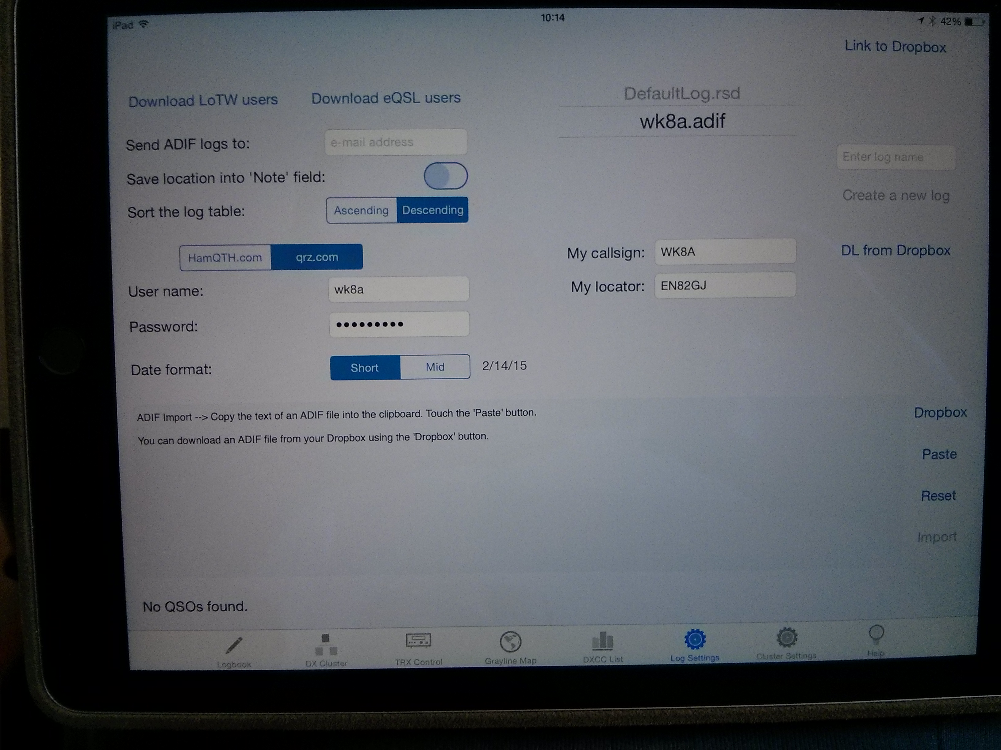

I will post a few shots. I have loaded the updated DXCC.rsd database. Here are a few things that don't seem to be working quite right.
1. Cluster seems to be showing all posts, not New ones only
2. From the logbook (or the spots), if I touch a call sign, the Entity box does not show the record of QSOs with that entity, but the right hand box showing the QSOs with that station seems to be reporting correctly.
3. The DXCC List does not show the list of worked or confirmed stations accurately. I have DXCC on 40-10 meters, and the screen shot only shows the most recent few entries in my log.
I imported my log using the ADIF import from Dropbox. I must have some settings that are incorrect. I have an iPad Air 2 with 128 gigs of memory.
73 de John, WK8A

Here are a couple more screen shots:
None of my QSOS with G are showing up in the box on the left (G is definitely not new for me). The other photo shows my DXCC list being much smaller than it should be

You can make better screen shots, pressing the Home and the Power button at the same time.
In your screen shot I see new ones only. All colored spots are new ones.
It seems, in your logbook the QSL status is not correct always. Can you copy your log using the iTunes File Sharing section and e-mail me it for investigation? Or your ADIF file you have imported?
