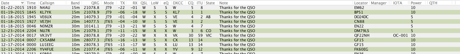

Out of 2106 records sent to QRZ.com:
Import Results:
1 QSO's were inserted
1263 duplicates were replaced
467 duplicates ignored
375 errors
Does not appear to affect all records. Most of the records shown in the attached should have been imported, but only 1, N0MZR was imported. Why that record was accepted and not the others is beyond me.
I highlighted the N4AU log entry and tried the recalculate DXCC and nothing changed.
Attached screen grab showing a portion of my screen:
