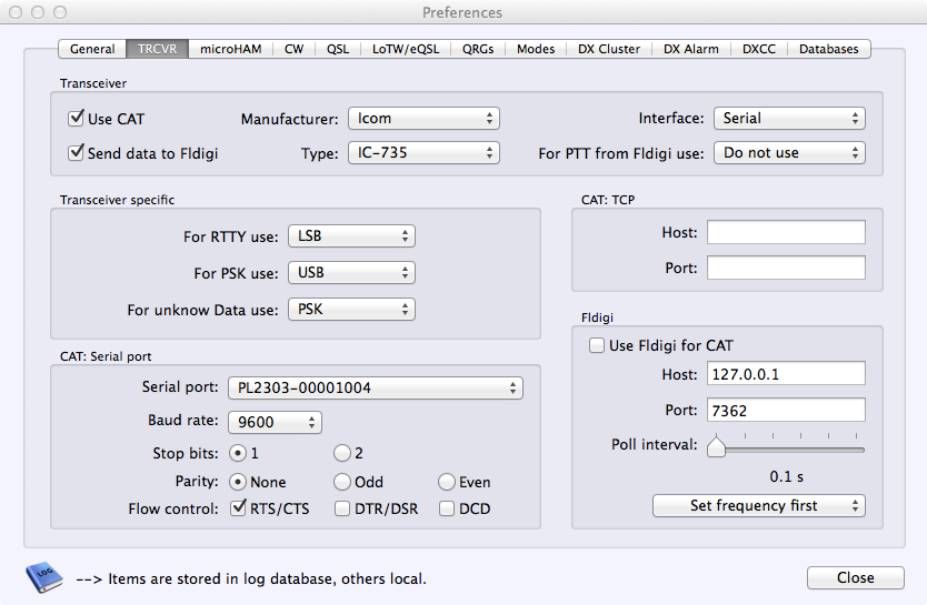

Here is a screenshot of my RUMlogNG "TRCVR" settings. I double checked my settings with RUMlog and FLDigi tracks just fine. I also had a tcpdump running and sniffing on port 7362 and no traffic was seen from RUMlogNG but plenty from RUMlog.

You have to enter the Fldigi address into the "Fldigi" section". You entered it into the "TCP/IP" section! This is used for CAT control over the net. Maybe it is not clear enough marked?

I populated the the fldigi section with the same values as CAT Tcp and still no go. Wonder what I am missing

Do not set the option "Use Fldigi for CAT".

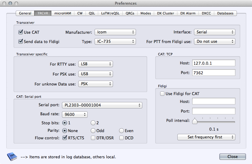

The version I have is version 1.0.2 (according to get info). I have a tcpdump running (tcpdump -nnvi lo0 port 7362) and I see no packets in tcpdump when I move my VFO both up and down. Rumlog changes but fldigi does not because it is not receiving anything from RUMlogNG.
Attached is the current setting I have set for my radio.
