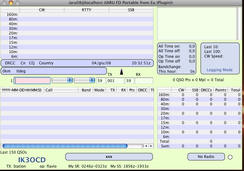

hello tom from flavio ik3ocd excuse, I note the absence of text message
Opening rumped and start new contest.
hello thanks for new version rumped I'm trying
73 cordial :roll:

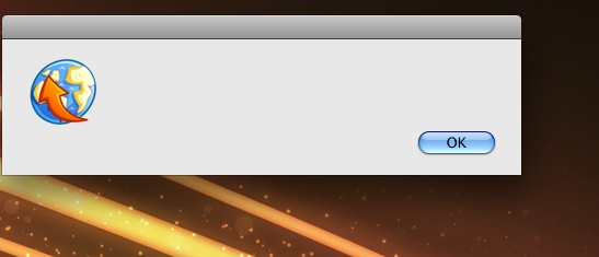

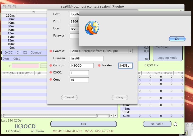

Hi Flavio,
interesting error message! :D
What happened after pressing the Okay button?
Did you run RUMped before successful?
Can you restart RUMped? Maybe using other contests?
It seems there is a MySQL problem using the "Show Databases" command. Do you you have changed the privileges from the user 'root'?

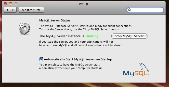

hello tom from flavio rumped departure ok I had to reinstall mysql
ok now seems strange? I think my problem.
ok see what happens in the future
Hello and thanks 73
Posts: 3120
Re: message rumped
Ok, fine Flavio. Under Leopard there are some issues using the MySQL preference pane. When the server is running, it is better to keep this pane untouched.
