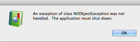

Hello. any other ham had the same problem every time i try to open telnet cluster,i get this message

Opps! :-(
Try to delete the cluster addresses in the preferences under the DX-Cluster tab.

DL2RUM wrote:Opps! :-(
nothing happens,I still have the same problem :oops: :o
Re: Rumlog 5.3
Please copy the file ~/Library/Preferences/RumLogOwn.plist and send me the file. Delete it and restart RUMlog.

Hello Tom,same problem Now in my MacbookPro,playing around for a while and click the call in the Spot dx Window don't grab the call grab the name and frequency ????and then closes!!!!!
I'm back to the previous version 5.2.6 is more stable :oops:I hope you find medicine and the right cure :mrgreen:

Thanks a lot for the file, this was very helpful. I was able to figure out the problem. I used some sound files, which are not any longer supported by OS-X.
For any reason this caused the crash. You have had activated the tones for the dx-cluster. It seems, I need a new set of tones for dx announcements. I'm not sure, if somebody else uses this.
This version should work for you: Download the application only: http://dl2rum.de/rumsoft/RUMlogApp.zip
