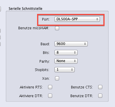

Is the COM port recognized correctly?

Thanks for your reply. Can you tell me how I can verify this?

Check if you have selected the COM port which is connected to your transceiver. When you have installed the interface driver, the name should be listed in the popup menu.
COM port.png (18.8 KiB) Viewed 14913 times

Thanks so much for your assistance. I don't have the driver. That option you presented does in not one of the options on my system. I'm searching for the correct driver right now to down load.

The port you see in my screen shot is not for TS-590, it's for another device.
When you use a USB-Serial converter cable, you will need the applicable driver for that interface.
When you use the direct USB connection, you will need the driver for the chip inside the TS-590, most probably a Silicon Labs chip. But I'm not sure about this.
