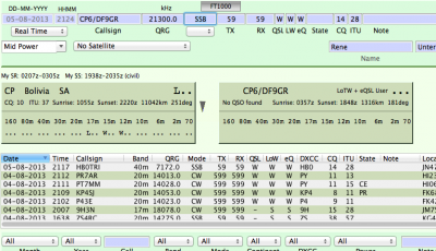

Here you see an example CP6/DF9GR and the beam heading points to DL .....
I get this result by both taking over the call from the band map or entering the callsign manually into the callsign logging field.

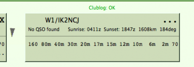

another example: W1/IK2NCJ ... pointing to Italy instead of W1
73 de LA0FA
Posts: 3137
Re: RUMlog 5.1.4
Oh, this seems to be another story. Do you use the Auto fill up option from qrz.com?
For these portable stations qrz.com returns the data from home. So the grid square is most probably wrong.
Please check the grid square in the Locator field when you see a wrong direction. RUMlog uses the exact station location for calculation when available.
