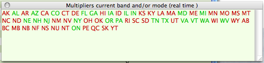

5) Multis (RT-Text): (rumped>>window>> multis (RT Text) ) This is a handy way to see what mulitliers I've worked and which ones I'm still looking for. If it was organized by call area it would easier to read. Such as:
1 NH ME VT MA CT RI
2 NY NJ
3 PA MD DE
4 VA NC SC GA FL TN KY AL
5 TX AR LA MS OK NM
6 CA HI
7 UT NV MT ID WY OR WA AZ
8
9
0
etc etc.
