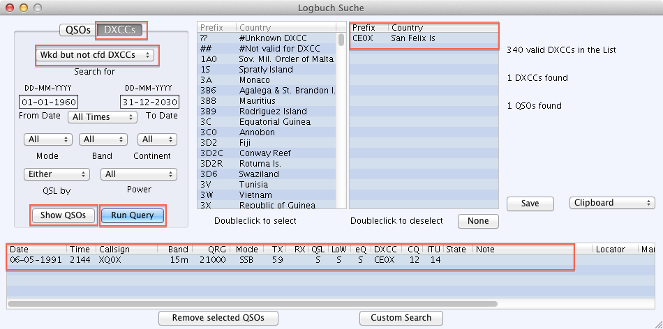

  • Open the "Search Window": Menu-->Window->Search
  • Select the "DXCCs" tab in the upper left corner
  • Select "Wkd but not ccd DXCCs" from the popup menu below
  • Select a band and or a mode to see also new band/mode QSOs
  • Push the "Run Query" button --> All wkd and not cfd DXCCs are listed in the right hand table
  • Push the "Show QSOs" button --> All wkd and not cfd QSOs from the DXCCs in the table are listed now in the QSO table
  • Go to Menu-->QSL-->Send again paper QSL
  • To print the cards: Go to Menu-->QSL-->Print paper QSL

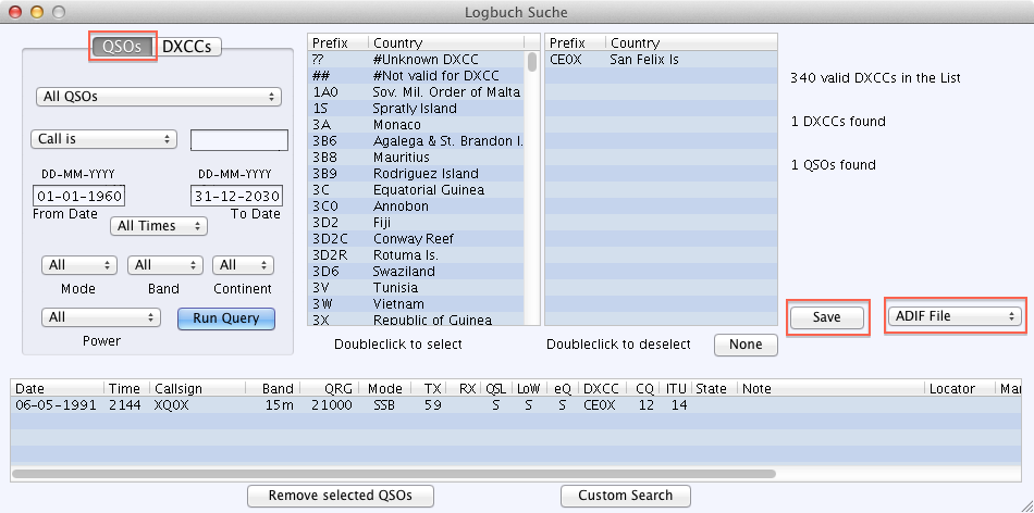

To save the QSOs as ADIF file:
  • Select the "QSOs" tab in the upper left corner
  • Select "ADIF" from the popup menu on the right side
  • Push the "Save" button
