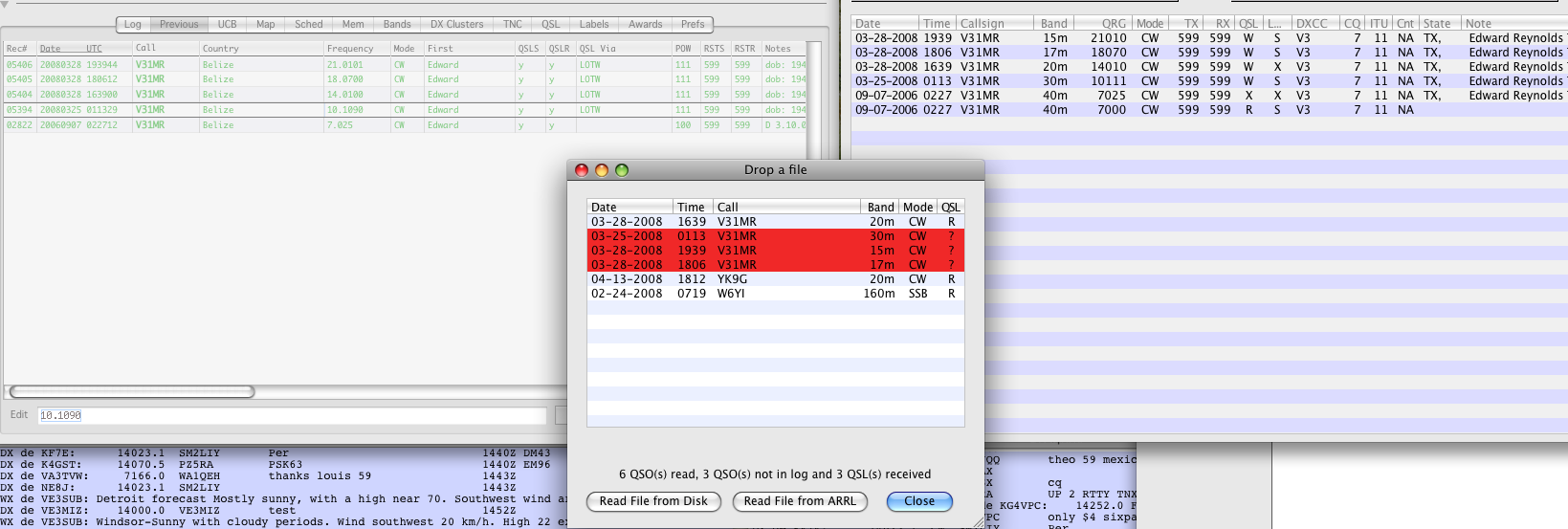

Just had a strange anomaly. I uploaded my latest log to LOTW (Via MLDX) Haven't had time to figure out the qsl export yet in RUMlog.
I see I had some new QSl's. When I had RUMlog read the data from LOTW it showed that some of the Q's were not in the log, but in fact they are.
Here is a screenshot. What did am I doing wrong? I imported the log from MLDX and other Q's do show up fine.
Thanks,
Lee WW2DX

Re: Sort bug
Posted: Thu 17. Apr 2008, 15:37
we have had this problem before, but I was sure this is fixed now. :cry: :cry: :cry:
It could happen, when the seconds in the QSO time do not match. How did you do the import? Direct from the server or via a downloaded ADIF file? How did you imported your QSOs in RUMlog?
It would be helpful, when you can e-mail me your log and the downloaded QSL adif file.

I exported my log from MLDX (ADIF) and imported into RUMlog. MLDX logs look like this after export ADIF.
Here is the actual V31MR entry that RUMlog does not match.
<MY_GRIDSQUARE:6>FN31en<CALL:5>V31MR<OPERATOR:5>WW2DX<NAME:15>Edward Reynolds<ADDRESS:24>11214 Olde Mint House Ln<QTH:18>Tomball, TX, 77375<STATE:3>TX,<GRIDSQUARE:6>EK57um<QSO_DATE:8>20080325<TIME_ON:6>011329<TIME_OFF:6>011329<FREQ_RX:7>10.1090<FREQ:7>10.1110<BAND:3>30M<MODE:2>CW<QSL_COMMENT:15>dob: 1941-12-31<DXCC:2>66<RST_SENT:3>599<RST_RCVD:3>599<TX_PWR:3>111<CQZ:1>7<NOTES:15>dob: 1941-12-31<EOR>
As for the downloaded QSL adif file, do I do this through RL or is that through LOTW?
de Lee
WW2DX
Re: Sort bug
Posted: Fri 18. Apr 2008, 03:08
Please note the email I sent to lee at ww2dx dot com
