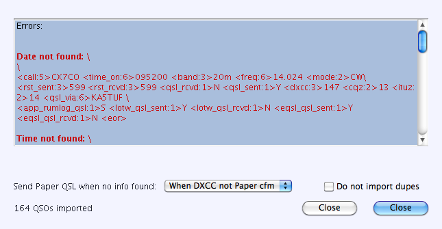

The import window itself shows the errors:
You can copy and paste the error messages for further investigations:
Date not found:
<call:5>CX7CO <time_on:6>095200 <band:3>20m <freq:6>14.024 <mode:2>CW
<rst_sent:3>599 <rst_rcvd:3>599 <qsl_rcvd:1>N <qsl_sent:1>Y <dxcc:3>147 <cqz:2>13 <ituz:2>14 <qsl_via:6>KA5TUF
<app_rumlog_qsl:1>S <lotw_qsl_sent:1>Y <lotw_qsl_rcvd:1>N <eqsl_qsl_sent:1>Y <eqsl_qsl_rcvd:1>N <eor>
Time not found:
<call:5>CX7CO <qso_date:8>20071108 <band:3>20m <freq:6>14.081 <mode:4>RTTY
<rst_sent:3>599 <rst_rcvd:3>599 <qsl_rcvd:1>N <qsl_sent:1>Y <dxcc:3>147 <cqz:2>14 <ituz:2>36
Callsign not found:
<qso_date:8>20071108 <time_on:6>143200 <band:3>15m <freq:6>21.085 <mode:4>RTTY
<rst_sent:3>599 <rst_rcvd:3>599 <qsl_rcvd:1>Y <qsl_sent:1>Y <dxcc:3>384 <cqz:2>20 <ituz:2>39
<app_rumlog_qsl:1>X <lotw_qsl_sent:1>Y <lotw_qsl_rcvd:1>N <eqsl_qsl_sent:1>Y <eqsl_qsl_rcvd:1>N <eor>
Frequency/Band not found:
<call:9>HB0/HA0HW <qso_date:8>20071108 <time_on:6>215900 <mode:2>CW
<rst_sent:3>599 <rst_rcvd:3>599 <qsl_rcvd:1>N <qsl_sent:1>Y <dxcc:3>251 <cqz:2>14 <ituz:2>28
Mode not found:
<call:6>9M6XRO <qso_date:8>20071108 <time_on:6>221700 <band:3>80m <freq:5>3.508
<rst_sent:3>599 <rst_rcvd:3>599 <qsl_rcvd:1>N <qsl_sent:1>Y <dxcc:2>46 <cqz:2>28 <ituz:2>54
Band/Frequency disagree:
<call:5>CO8LY <qso_date:8>20071108 <time_on:6>222400 <band:3>30m <freq:5>7.002 <mode:2>CW
<rst_sent:3>599 <rst_rcvd:3>599 <qsl_rcvd:1>N <qsl_sent:1>Y <dxcc:2>71 <cqz:1>8 <ituz:2>11 <comment:13>Eduardo CQing
