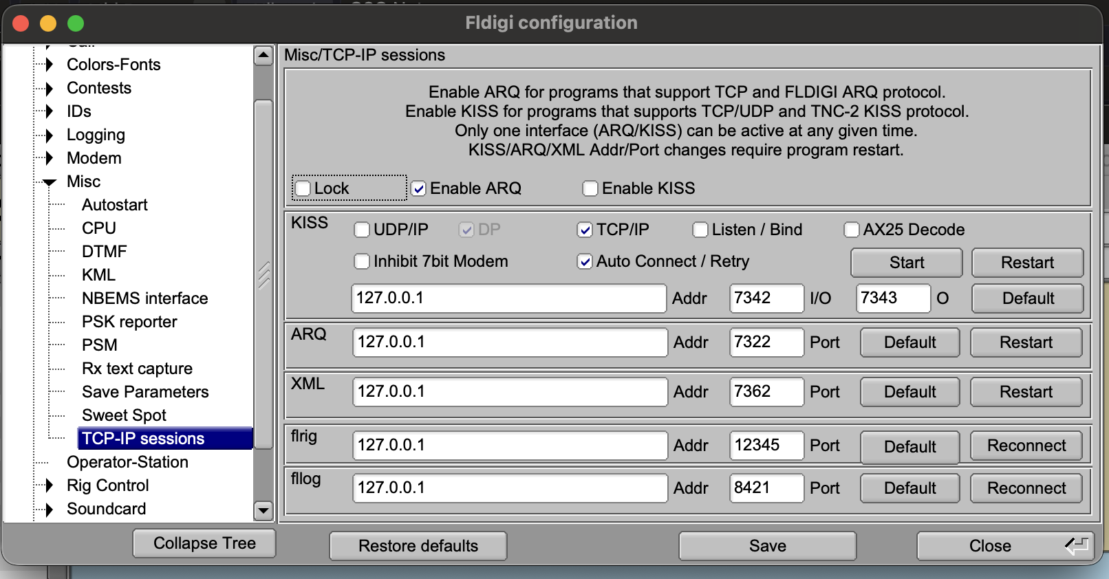

I have not been able to have RumLogNG assert CAT control of FLdigi.
RumLogNG 6.3.1
FLDigi 4.2.11
Rig Icom IC7610
Ethernet Connection via Icom Server
I have attached screenshots of my RumLogNG & FLDigi settings.
I tried replacing the host location of 127.0.0.1 with IP address of my MacBook. Still did not connect.
If you are using an Icom IC7610 with RumLogNG and FLdigi successfully via ethernet, could you please share your settings with me?

In RL you should set the port to 7362. What you see is just a placeholder, you haven't entered a number.

Thank you very much! RumLogNG now responds to PTT command and reflects mode change. However, FLDigi is not reflecting the IC7610 frequency. In RumLogNG, I selected "Send Frequency First."
What setting do you think I'm missing?

This setting works for me. When I turn the VFO knob, fldigi changes the indicated frequency.
