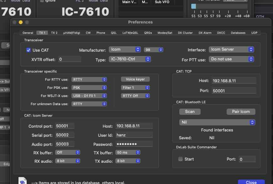

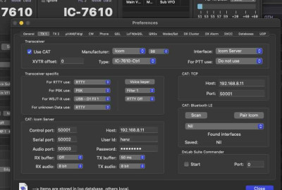

\and his is the set up:
the radio is communicating with the network, the NTP connection works.
73 hanz
