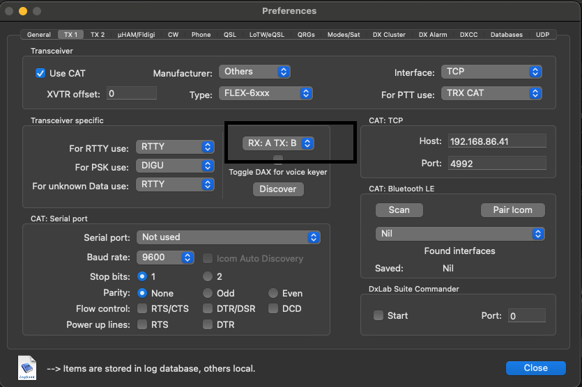

I am looking for a way to configure the second Panadaptor of my Flex 6600 as Trx#2 in the RumlogNG. Trx#1 is already connected to the 1st PanAdaptor and use the port 4992 Flex to communicate. Is it possible to use the second PanAdaptor as Trx#2 in RumlogNg? If So which port to be used ? I have tried 4993 and 4994 ports along with the IP address of Flex 6600 , but it doesn't really communicate.

The access data are the same. You have to select in the RL TRX Preferences which slices you want to use for TX/RX.

Thanks for the reply, I tried to configure RumLogNG to use same IP address and Port 4992 of FlexRadio as Trx# 2.
As you see the Flexradio configuration I have to always use the split mode in each pan adaptor which is not realistic in a day to day operation.
Most of the time the there will be one slice per pan adaptor and the Flex will name it as Slice A binding to the PanAdaptor -1 Slice B binding to the PanAdaptor 2.
Appreciate if you could provide another option Rx-A Tx-A and Rx-B- Tx-B in the Tx-1 and Tx-2 configuration page so that the 2 PanAdaptors of Flex 66xx can be treated as 2 different transceivers .
