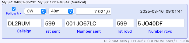

In this setup, I have manually entered the counterpart’s sent sequence number, followed by a space and the locator, into the "Number rcvd" field. During a real contest, I find it challenging to input all these details quickly enough.

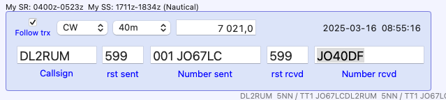

As per your advice, I tested the DARC VHF Contest, and I can confirm that the locator pre-filling works as expected:
However, when operating in RUN mode, I need to modify the "Number Received" field before pressing enter in order to save the correct response. I would need to adjust it like this:
To do this, I currently have to:
Use the left arrow key to move the cursor before the highlighted locator.
Manually enter the serial number (e.g., "5" in this case).
Add a space between the serial number and the locator.
Finally, press the ESM key to save the QSO.
This process is quite challenging in a fast-paced contest environment. By the time I complete these steps, my counterpart will likely have already resent their exchange, assuming I didn't copy it correctly the first time.
