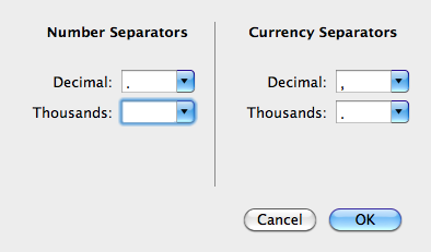

I was in contact with Neal, K3NC to inform him about this possible bug. A 'normal' dx-cluster sends spots with the frequency formatted like this: 14195.0 - No comma for the thousands and a period for the decimals. RUMlog expects this normal used format.
It seems to me, Spot exports frequencies in the format you have selected in your System Preferences in the "Language & Text section" under the "Formats" tab.
Try the following: Customize your system settings to remove the comma, separating the thousands. When the dx-spot is showing up correct, you should contact the author from the software you have payed for.

Thanks, That cured it. I changed the separator for thousands in numbers to none.
