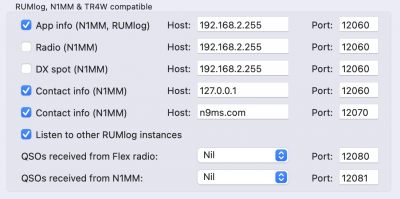

I wanted to share a scenario to see if there is a better way to accomplish my task. In short, I essentially need to create a second port forwarding instance of 127.0.0.1:12070 to an internet address (QSOMAP n9ms.com:12070).
1-In RUMlog-->Settings-->UDP-->Contact Info (N1MM), I'm set to 127.0.0.1:12070
It is now broadcasting log data via the local host.
2- Then, those contacts are picked-up via the QSO uploader thusly: QSO Uploader-->Listen to-->UDP N1MM contact: Port 12070, Enable N1MM checked.
QSO data is being pushed to Clublog and QRZ.com successfully.
3- Now, I want to send that UDP traffic to n9ms.com:12070 but, from what I can see - with my limited knowledge - Rumlog does not accommodate any further forwarding.
Is there a way that I'm missing to send the UDP packets to another address? Is this something I must do with my Mac networking to forward the IP and port to QSOMAP?

Currently you can just use one address for the <contactinfo> broadcast. Maybe I have to add another set of settings. I'm in touch with Mike, N9MS concerning QSOMAP.

Mike, N9MS has worked hard to make QSOMAP RUMlog (better: N1MM) compatible. Give it a try, but send the Contact Info only. Do never send other UDP messages to QSOMAP!
The next RL release will include a second set of settings.

Thanks for the awesome and agile implementation of the second settings.
