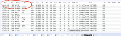

I use Rumlog for as long as I use Mac. I love it. It's a vy nice logbook. I had never problems, but now I have (maybe?) a simple problem.
I use a Macbook Pro 2022 and Rumlog 5.9.1

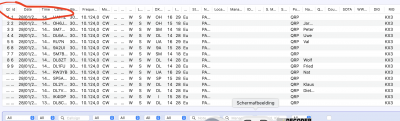

When I close and reopen Rumlog, the columns are reset to the default values. And not as I have set it myself. What can I do about it? On my iMac, that's not the case. And everything stays nicely in place. I hope you can help.
Thanks in advance for the reply. Tonnie - PA9CW
Doesn't remember columns settings

I tried your tip. But it does not seem to solved the problem. All the colums go to default value again.
