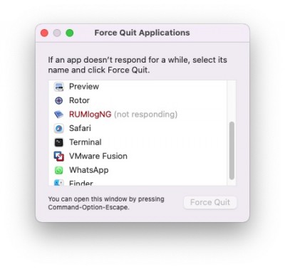

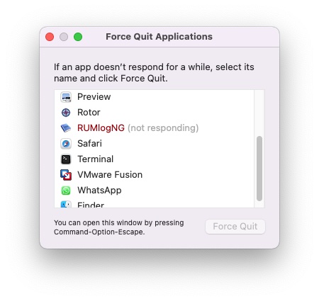

Does anyone have any clue why RUMlog hangs after a few minutes, (2-10 minutes approximately), when using CAT with a YAESU FDX10? Until the hang moment it works like a charm!

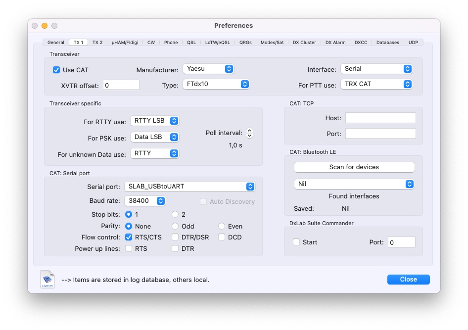

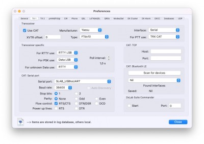

I have pinpointed that when I click on a spot on a band map, at this very moment, it may hang. However, all clicks and consequent frequency change or even band change, until the hang moment, are fully successful. Only after some certain click, RUMlog hangs. I have tried several CAT settings options, both in RUMlog and in the menu of the radio, with no satisfactory results. I have no issue, no issue at all, with the same computer and a KENWOOD TS-590SG.
