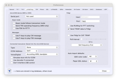

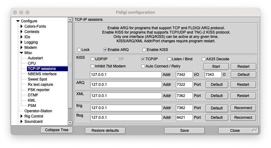

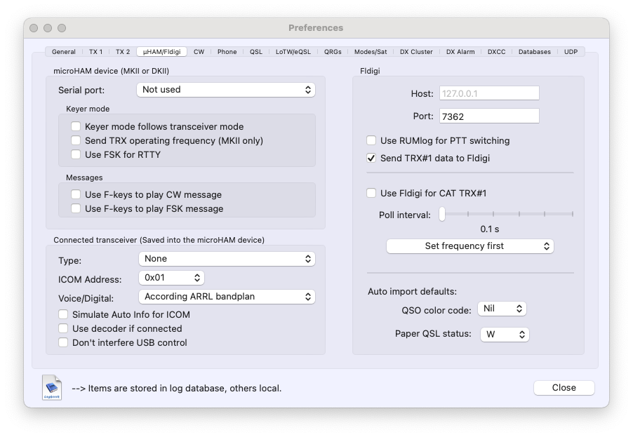

Thanks for the reply. I'm having no luck getting RUMlogNG to control FLDigi (v 4.1.20 for BigSur). I do have RL working with WSJT-X. This is on a M1 Mac mini with Monterey. Attached are what I think are the appropriate RL and FLDigi confiig screens.
Mark, N8ME
FLDigi Setttings
FLDigi Setttings
RL Settings
RL Settings
Posts: 3112
Re: RL / Without Wire / FLDIGI
You have to enter the host address where Fldigi is running.
N8ME
Posts: 12
Joined: Fri 3. Dec 2021, 21:24
Unread post by N8ME »
That was it. Thanks!. I saw the 127.0.0.1 already in the field, so I thought that was the default.
