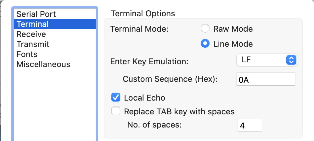

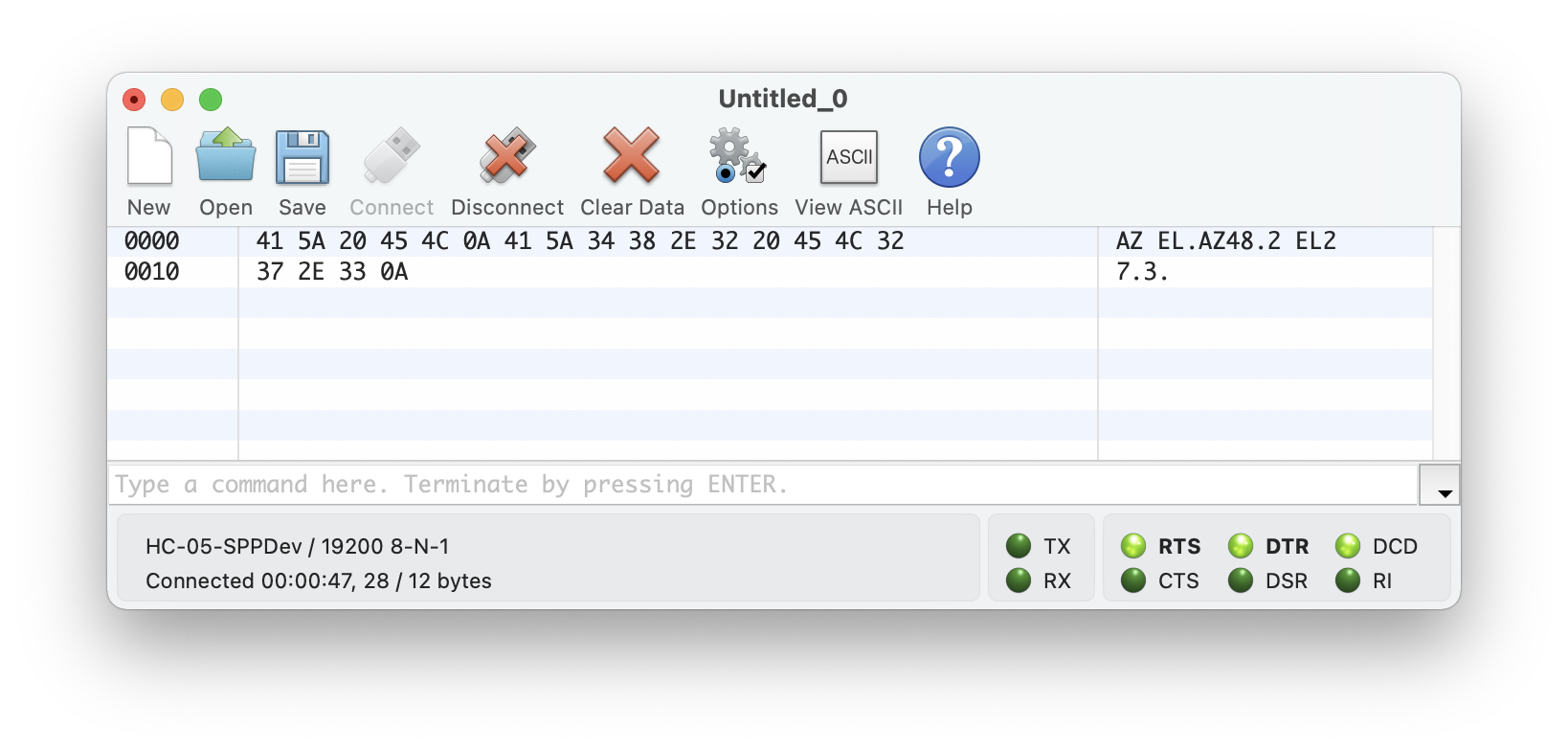

Can you provide similar screen shots? I've just sent AZ EL 0x0A The return was AZ0.2 EL-0.3 and AZ48.2 EL27.3 The answer must be terminated by a 0x0A

Tom, the problem is not the serial terminal, when I send AZ EL 0xA I get the current position, like AZ 90.2 EL 10.3, as expected.
The problem is, when I use your rotor program (rotor control window) and turn horizontal direction or grid to 90 deg, then the rotator turns to the desired position, but the display (Azimuth) stays at 0 deg.
